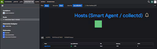

Next, let’s look back in our SignalFx account on www.signalfx.com and validate that we are seeing our host and metrics are flowing from our newly installed agent. Once you are in SignalFx click on the “INFRASTRUCTURE” tab at the top and click on Hosts (Smart Agent / collectd ).
Here we should see our host where we just installed the SignalFx agent. Your infrastructure navigator should look similar to the image below:

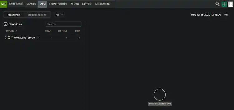

Log into SignalFx and navigate to the µAPM tab located at the top. This opens the APM monitoring dashboard with all of our services and their respective Requests, Errors, and Duration (RED) metrics and service maps on the right. By understanding the current rate of requests, errors, and durations (aka latency), we know, at a high level, if this service is alive and successfully serving requests in a timely manner.
Note, all of this is dynamically built seconds after the SignalFx cloud receives your traces. You should see a new service running called “TheNewJavaSerice” as shown in the image below:

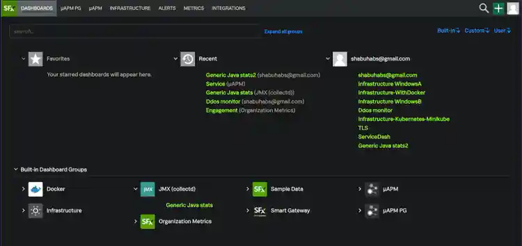

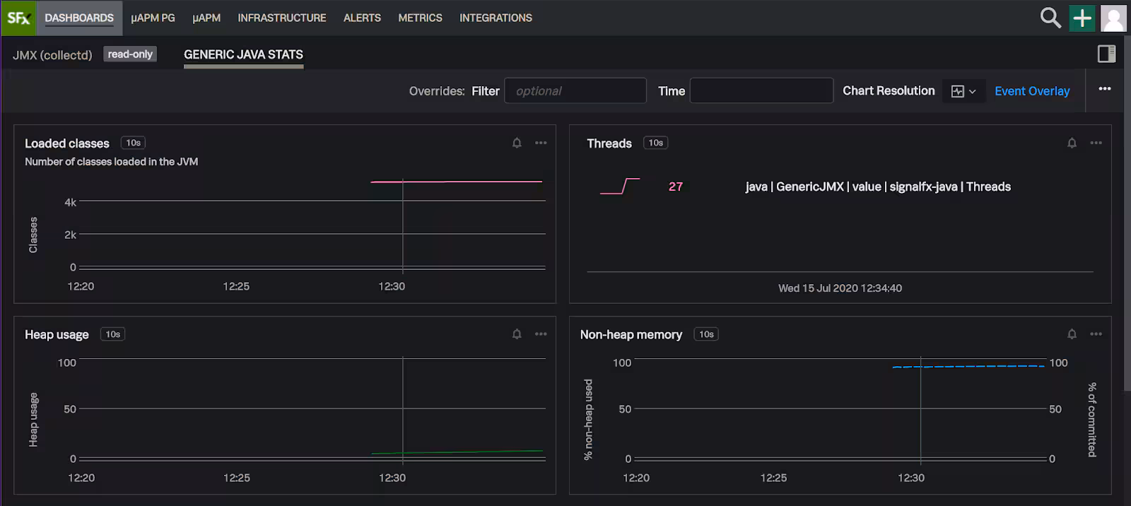

Open the Generic Java Stats Dashboard

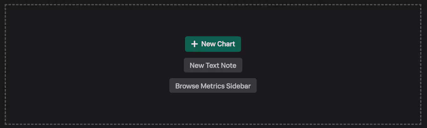

Navigate to the bottom of the new dashboard you just saved and click on “+ New Chart”.
Type in "jmx.threads", you should see jmx.threads.deadlocked.count auto-complete for you.
Select Single Value Chart
Select “Latest Rollup” under F(x). Note: your number of deadlocked threads may be different than what you see here as it depends on how many times you access the /deadlock endpoint of our Java Application. After validating there are deadlocked threads present, you can “Save and Close” your new chart in the upper right corner.
Name Your New Chart

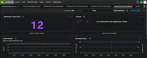

You should see your new chart now at the top when you click “Dashboards” in the main menu.
Now access http://<Host where you ran mvn exec:exec>:8888/deadlock several more times.
Notice the number of threads has gone up in the top right chart, in this case, from 33 to 41 and the deadlocked thread count went from 4 to 12.
