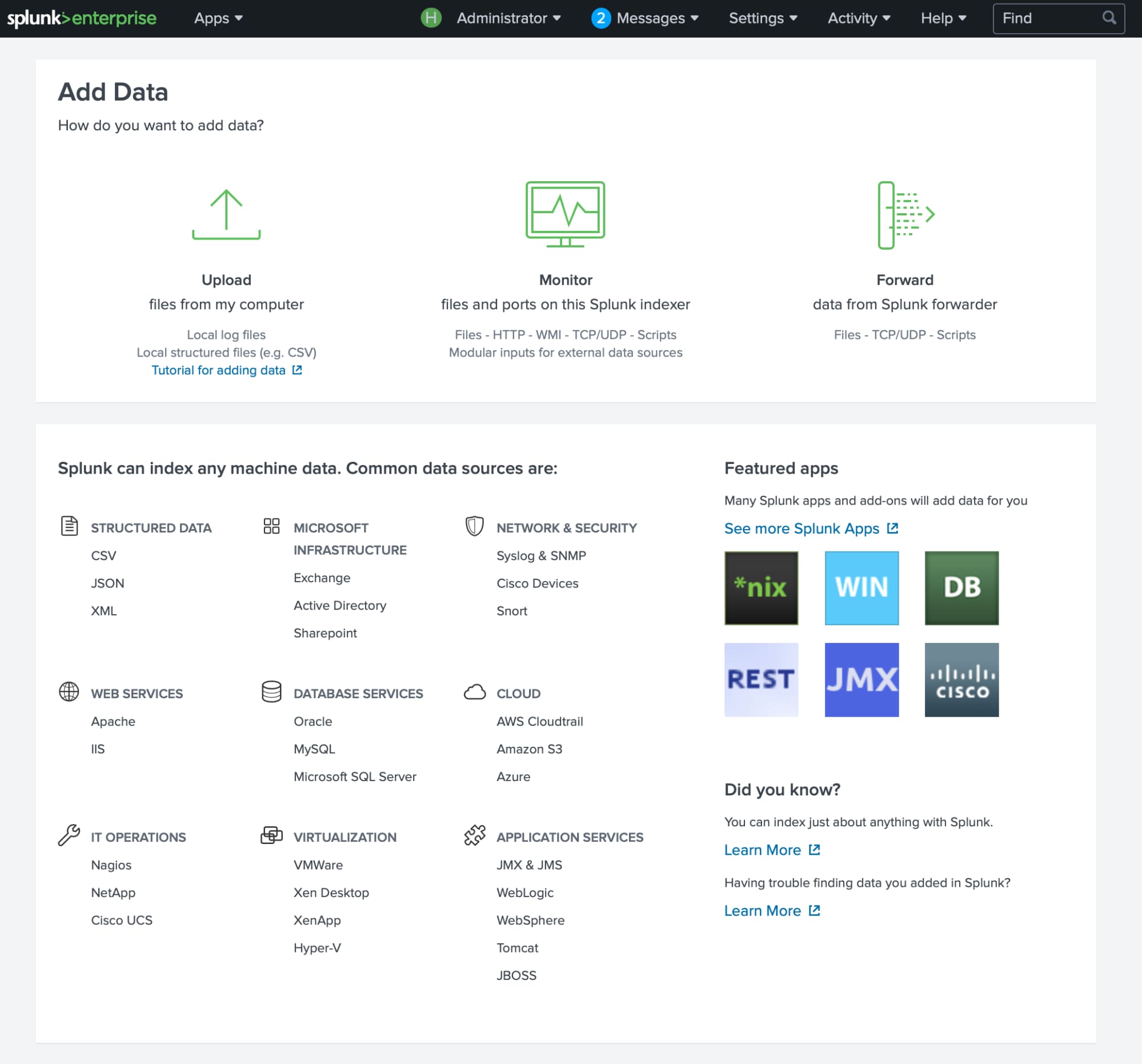

After I received your feedback, I decided to try ingesting data for myself. My goal was to ingest it from a Cisco ASA device, and I decided to start with the Add Data page, which you can see below.
When I got to this page, how to get data in from my Cisco ASA device was not obvious. How does Upload, Monitor or Forward relate to my goal of configuring my Cisco ASA device to send data to be indexed in Splunk? I was not certain.

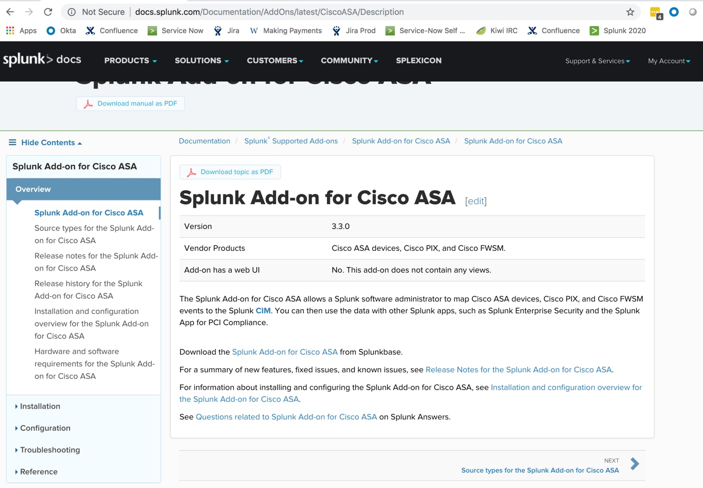

So then I thought it must be covered on Splunkbase, because I knew about apps and add-ons on Splunkbase that can be download and installed on Splunk. I found the Splunk Add-on for Cisco ASA overview page, but it still was not clear how to use the Add Data page to install the app and configure the device to send data to Splunk.
As I read the overview page, I saw the “Installation and configuration overview for the Splunk Add-on for Cisco ASA”. This link provided me with some information, but I realized there was so much more that I need to understand before I could proceed. I needed to understand Search Heads, Indexers, Heavyweight Forwarders, Universal Forwarders, Light Forwarders, Search Head Clusters, Indexer Clusters, and the Deployment Server. After spending considerable time going through the documentation, most everything was there, but I had to piece together everything to create my own instructions. I also had the advantage that when I got stuck, I had experts readily available to answer my questions.

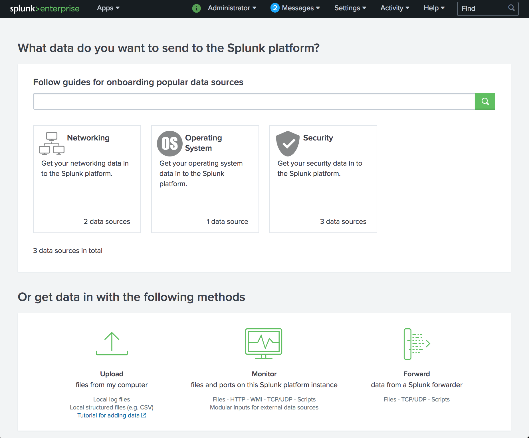

You are probably asking “what is Guided Data Onboarding (GDO)?” GDO is end-to-end, task-based guidance that starts from the Add Data page in Splunk Web. This new experience provides a guided experience for configuring and installing Splunk add-ons for your specific Splunk deployment environment. If you have a Splunk deployment up and running, and you have an admin (or equivalent) role that lets you install add-ons, you can use these guides to get popular data sources into your Splunk platform deployment.
To access the new Guided Data Onboarding feature, select the Add Data Screen from your home page in Splunk Web. You can either search for a data source or explore different categories of data sources. Currently, the categories are Networking, Operating System and Security
If you are comfortable using the past approach, it is still available to you—see the section that follows the orange rectangle.

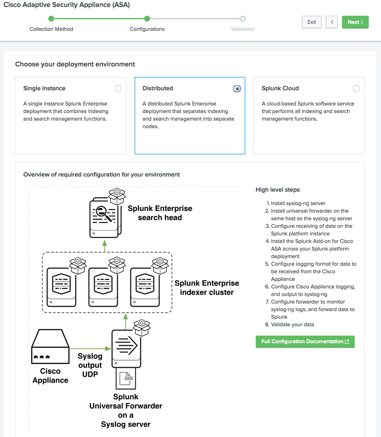

When you use Guided Data Onboarding, after you select your data source, you must select a deployment scenario. Then, you can view diagrams and high-level steps to set up and configure your data source. As you can see from the screenshot below, this guided experience provides high level steps for installing and configuring a Cisco ASA appliance to send data to Splunk, versus the experience where I had to put this together myself.
If you need more details, follow the Splunk Web links to documentation that explains how to set up and configure your data source in greater detail. You can find all the Guided Data Onboarding manuals by clicking the Add data tab on docs.splunk.com. We also provide a simple SPL query so that you can verify that your data has been successfully ingested into Splunk.
