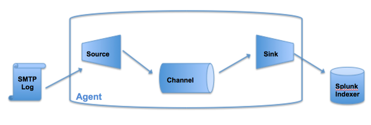

Do not panic as a solution that does not require development exists. Splunk is a universal machine data platform and does not impose hard requirements like other point solutions. We will therefore leverage the default Flume Thrift sink to send our SMTP log to Splunk after consuming it. The diagram below illustrates the process.

The sample configuration file provided below continuously reads the SMTP log file and sends new events via TCP to the Splunk indexer. In our example, the Flume agent is called Splunk.

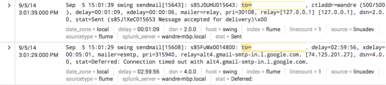

3) Configuring line breaking in Splunk
Because some of the SMTP log events will come across merged, we need to configure line breaking in Splunk to properly handle the events. This is easily handled using the following regex “LINE_BREAKER = (\\x\w{2})+”, in our use case. We also used Splunk to set the appropriate host at input creation time as Splunk offers many options for setting parameters.  Below is a screenshot of  those SMTP events after being ingested and indexed in Splunk.
