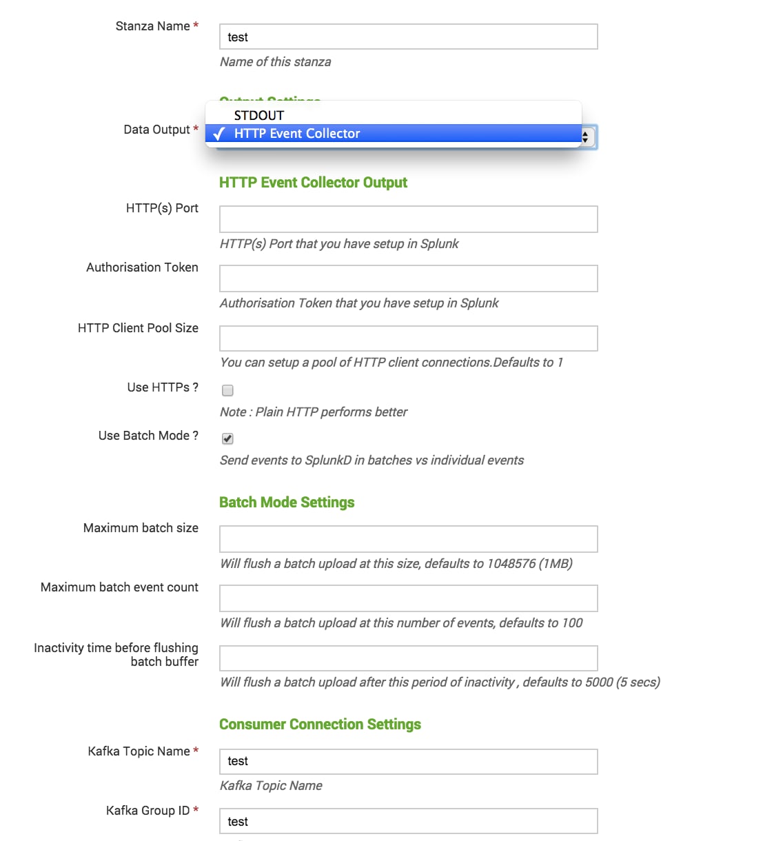

Enabling HEC for the Modular Input

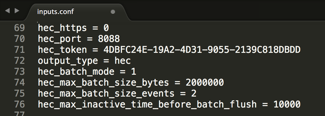

This can be done via a manager setup page in SplunkWeb for the Modular Input stanza.The example below is taken from the Kafka Modular Input.
Or you can setup HEC by editing inputs.conf directly if you do not have a SplunkWeb UI ie: deploying on a Universal Forwarder.

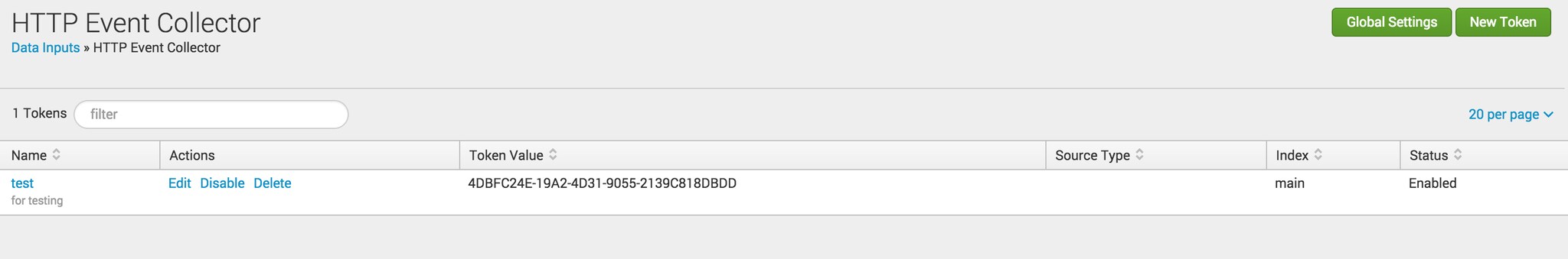

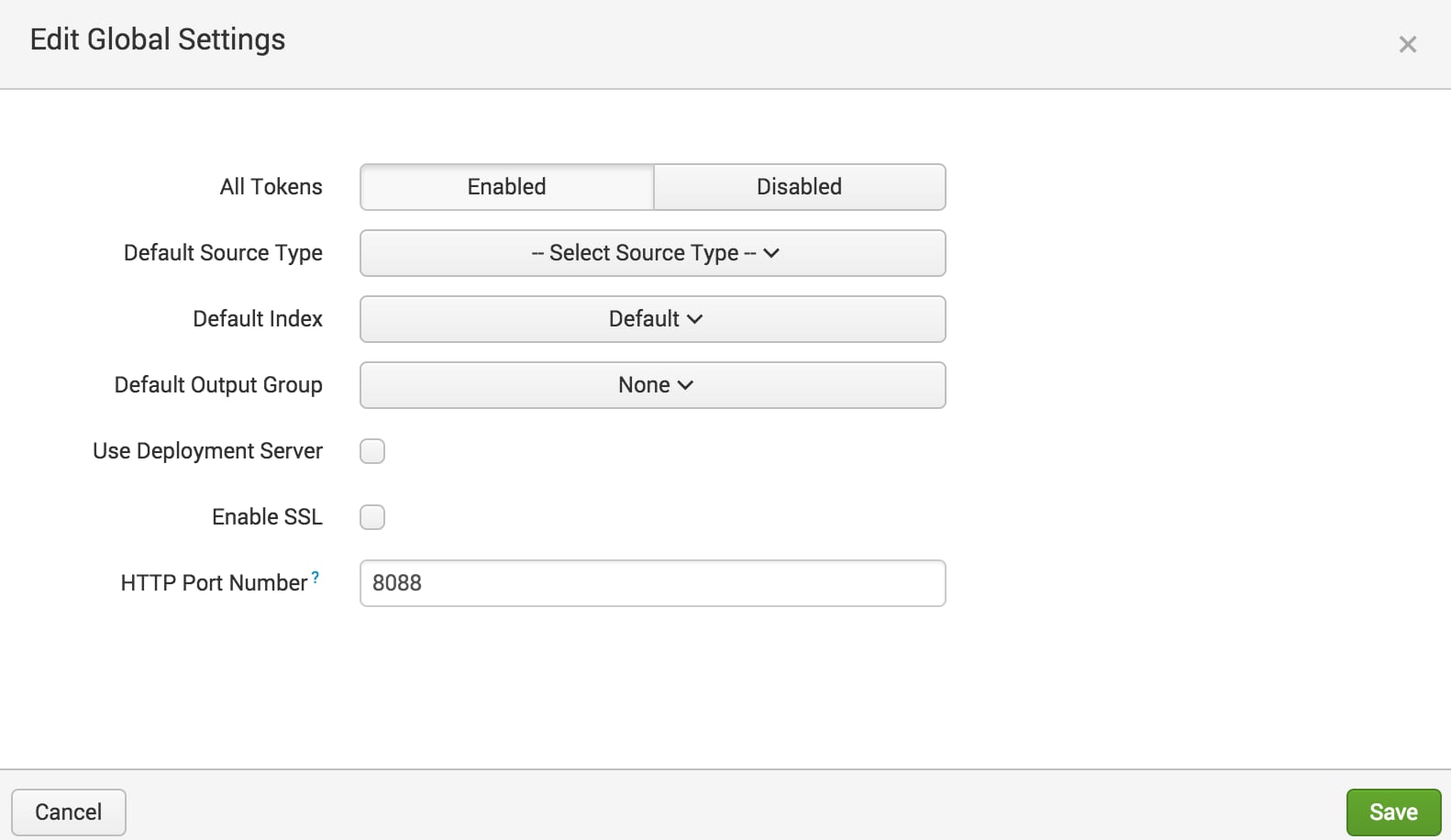

The token , port and https settings are whatever you have specified when you setup your HEC input in Splunk.

HEC also supports sending batches of events to Splunk which is recommended for superior performance. So I have also implemented this and provided the necessary knobs and dials to allow you to configure this for your environment. The batch size and flushing is controlled by the first of 3 possible thresholds being met :
- Data Size : send the batch of collected events to Splunk when this data size is reached
- Event Count : send the batch of collected events to Splunk when this number of events is reached
- Inactivity time : send the batch of collected events to Splunk after this time period of seeing no events arrive
