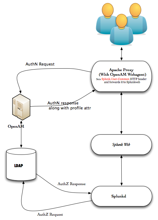

2.0 The Theory
It is relatively very simple process to integrate the splunkweb in to an existing OpenAM/OpenSO infrastructure. As you know the splunkweb is front-ended by a proxy server, traditionally  it is the proxy server that will authenticate to the backend identity repository  and sets the appropriate HTTP request header which will be consumed by  splunkd to create the authenticated session.  In this deployment the  identity in the HTTP request header is set by the  OpenAM after a successful authentication. This is achieved by  the OpenAM web agent plugin that is installed in the proxy server that is sitting in front of the splunkweb(refer the image below). When a request for the splunkweb URI comes to the proxy from the client, the OpenAM agent intercepts and authenticates it before letting it go through(assuming it is not already been authenticated) as part of this process the HTTP request header will be set by the OpenAM agent plugin running as part of the proxy server. From then on it takes the normal course of performing the SSO process as described in my earlier post.

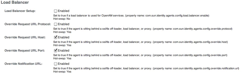

  • Enable the Request Host/Port override, since it is a proxy agent

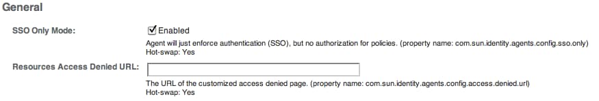

  • Set the SSO only mode, we do not want the authorization from OpenAM, just authentication is sufficient

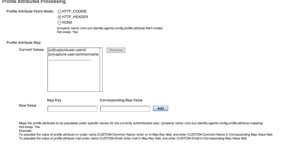

  • Set the profile attributes in the HTTP request header ( Splunk-User-Commonname ), this will be consumed by Splunk to perform the SSO integration. Even though you set header name in all lowercase, it comes out as Splunk-User-Common, hence this is the one you have to use in your web.conf property file.

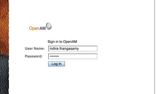

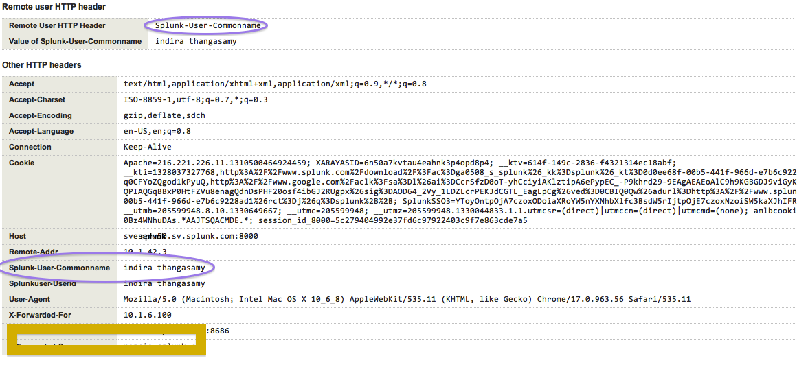

The configuration part is done. You can test the SSO scenario now by invoking the proxy url http://proxy.splunk.com:8686/ using new browser instance, this will redirect to the OpenAM login page as there is no prior session existed. At this point provide the user identity and password, up on successful authentication, the OpenAM agent plugin running on the proxy server will set the common name of the user(in this case indira thangasamy) in the Splunk-User-Commonname HTTP request header. This header along with its value will be forwarded to the Splunkweb which inturn talks to the splunkd to perform the authorization, upon successfull verification of authorization(the user identity in the HTTP header should have a role mapping in Splunk), This user will be authorized because it is part of the Splunk Admin group in OpenAM which inturn mapped in to Splunk ‘admin’ role. This will let the user access the administrative user interface of Splunkweb.
As you notice, the HTTP header Splunk-User-Commonname is the key to get the whole thing working. If this value is not set then the SSO will fail. Ignore the yellow rectangle in the following screen shot, it is placed to mask some sensitive host data.
