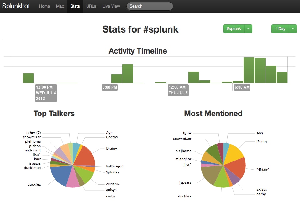

Second, I wanted to embed the charts and graphs from the dashboard I discussed last week into a web page so anyone could see them.  The JavaScript SDK makes this relatively trivial.  You can see the results on Splunkbot’s Stats page, and the code to accomplish it is contained in Splunkbot.prototype.timeline, loadcharts, toptalkers and mostmentioned functions.

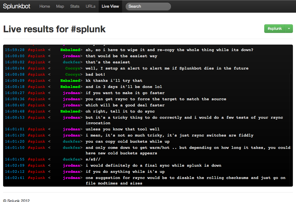

Third, I built an interface that would allow us to search logs for any arbitrary text and have them display back in a format that looks like an IRC client.  Also, and possibly coolest, we can use the same code to run a real-time search and display an IRC client like view of the channel in real-time.  Try it out, open up an IRC client and head to EFnet #splunk, and then type some text and watch the Live page, and you’ll see it show up in real-time.  For the code, check out Splunkbot.prototype.logsearch and Splunkbot.prototype.livesearch.
