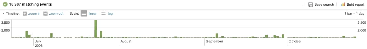

With that, you can do a simple search of “index=p4-sample” over all time, and get the following chart:
index=p4-sample
Files Changed Over Time

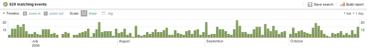

The spikes are very pronounced, probably due to mass updates of files at certain times. You can get the change info granularity by using the “dedup” command, and enter this in the search bar: “index=p4-sample | dedup change”, which yields a more informative graph:

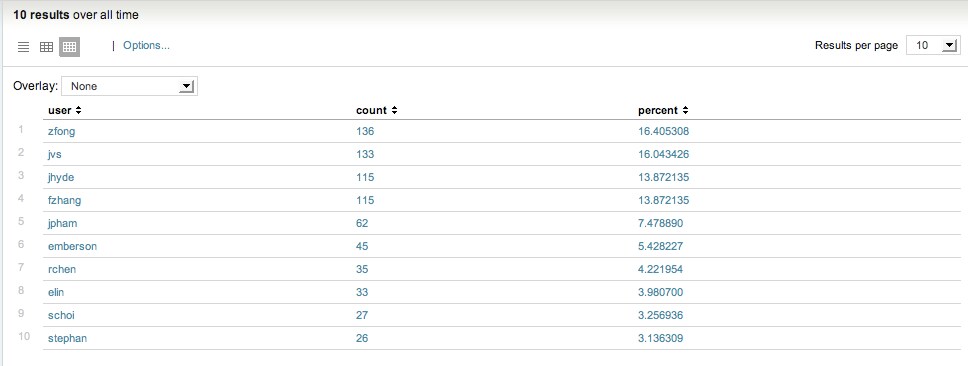

You can also do a top 10 report very simply. Try the following command:
 index=p4-sample | dedup change | top 10 user
Top Ten Submitters
Top Ten Submitters
This sample is of course a toy sample, since as I said, it’ll reindex the range of changes at each startup. However, from some very simple search strings, you immediately get visibility into what’s going on.
