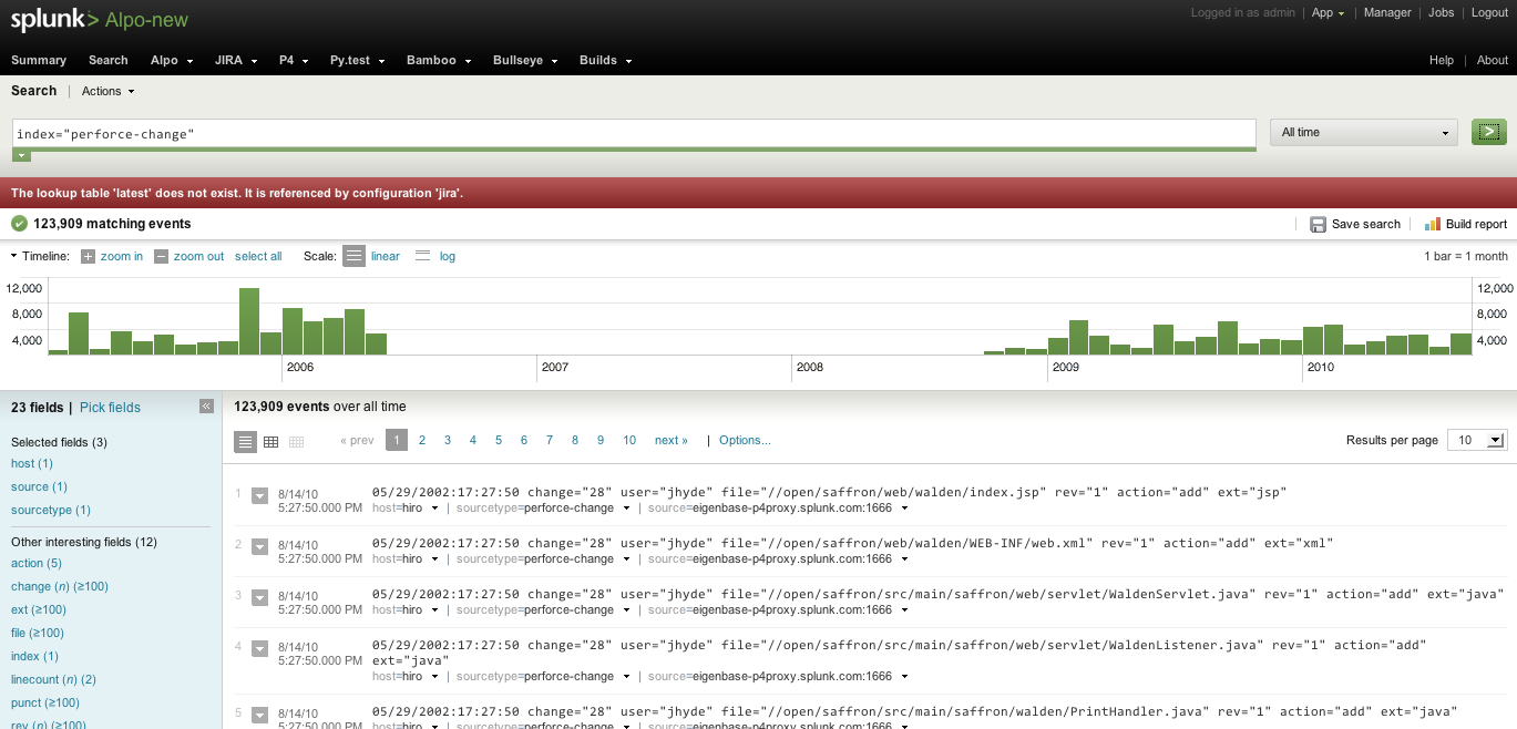

And it’s good I can do this, since it seems Splunk doesn’t recognize timestamps older than 2000 days ago (I also discovered the problem with the same search “index=perforce-change | head 1”). Since this P4 repository has been around since 2002, it results in this chart. The data hasn’t completed indexing yet, but without it completing I can tell something is off. The graph should be filling in sequentially, but there’s a huge gap.
Bad timestamping of older events
Look at the first event listed. It has an obvious timestamp of 5/29/02, however it is being set to the current date, 8/14/10, though the time of day is nicely preserved (ignore the banner error message, a side-effect of something else I’m working on). Adding the following to props.conf solves the problem.
MAX_DAYS_AGO = 100000
This is a heavy hammer, which says accept dates up to 100,000 days old from all sources. Don’t do this unless you know you want older timestamps. For a few more details on how timestamping works, see Guess What Time It Is.
A key lesson learned here is that since timestamping happens at Index time, your index can be polluted with junk data very quickly if this isn’t done right.
