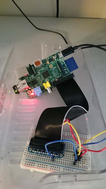

My buddy works for a Splunk partner and IoT company here in Brisbane, RIoT Solutions (www.riotsolutions.com.au), and so had a spare Raspberry Pi laying around. We figured, why not hook up a temperature sensor from Adafruit.com and log the data to find out? As it can take quite a while for a fridge’s temperature to plateau, trawling though the log files just wasn’t practical, and we wanted something that could tell us through trial and error if the changes we had made to the fridge were successful. So, we installed a small instance of Splunk on an Ubuntu VM in his home lab (despite me telling him to run it in AWS!).
Raspberry Pi temperature sensor

For details on how to build the Pi – https://learn.adafruit.com/adafruits-raspberry-pi-lesson-11-ds18b20-temperature-sensing/overview
