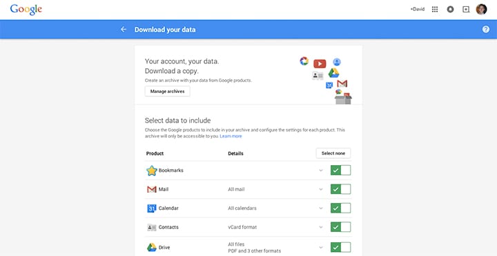

Download Your Inbox
Google Takeout
First, use Google Takeout to download your GMail mailbox. Depending on the amount of emails you have accumulated this might take a while. My ~15GB took about an hour.
Once complete, Google will give you a .zip file. Download and unzip it. You should see a file named something like “<my_gmail_inbox>.mbox”.

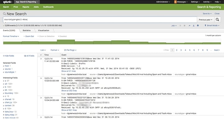

Splunk GMail
Now all you need to do is set this input as a new sourcetype (in the props.conf above I’ve used “gmail-mbox”) and then upload the file into Splunk.
A simple search for “sourcetype=gmail-mbox” should show all your events indexed and broken apart nicely.
As you can see from the screenshot above the events can vary quite drastically, e.g 21 line event to 821 line event. I have a number of events which are thousands of lines long (mainly the result of email bodies filled with HTML).
The histogram returned immediately gives us a good indication of month-on-month message volume. Note, this search shows both sent and received messages from your GMail account.

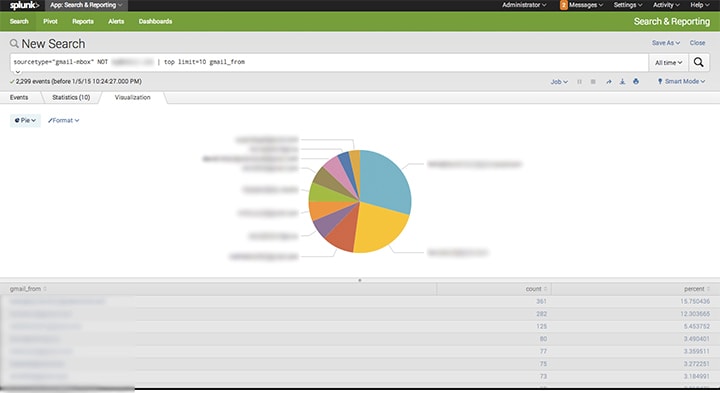

Splunk Gmail Top Senders
Here are some example searches to get you started.
Number of emails you’ve sent
sourcetype="gmail-mbox" gmail_labels=*Sent* | stats count
People you’ve received the most emails from:
sourcetype="gmail-mbox" NOT gmail_from=my@email.com | top limit=10 gmail_from
People you’ve sent the most emails to:
sourcetype="gmail-mbox" NOT gmail_to=my@email.com | top limit=10 gmail_from
