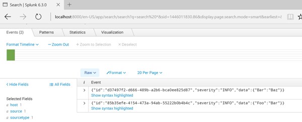

Assuming you have the proper Uri and Token and Event Collector is reachable, running the code will send events similar to the following into Splunk. Notice below the “data” field’s value is a JSON object, not a string 😉
Screen Shot 2015 10 28 at 12 57 41 AM
