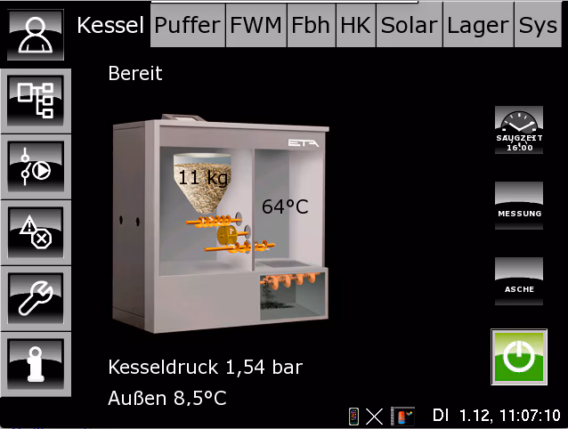

The “source device” – my PelletUnit
I recently installed in my house a brand new PelletsUnit from ETA – an Austrian manufacturer. It burns wood pellets to heat the boiler, providing warm water for the underfloor heating as well the radiators. It also houses the micro processing power to manage both these systems as well as the circulating pump and the solar heating system. The control panel is Linux based and I found that I could connect nicely via VNC for remote control. However, the system lags behind when it comes to reporting functionality. No data has been stored for useful historical analysis such as how many pellets are used over time, how the consumption compares to the outside temperature or how much energy/heat was produced by the solar heating system. As you can tell I had a lot of unanswered questions to address!

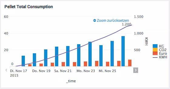

The outcomes were as follows:
index = "eta" sourcetype="eta:pellet:total_consumption_pellet"| eval strValue= strValue-6448| timechart max(strValue) as "KG" | eval CO2=(KG*0.003) | eval KWH = (KG*4.8) | eval Euro = KG*0.22680 | delta Euro AS "Euro" |delta KG as "KG"
This resulted in the following calculations:
- 1 KG pellets produces 0.003 KG CO2
- 8 pellets produce 1 KWH
- 1 KG Pellet is bought for 0.22680 Euro

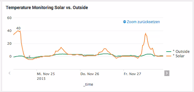

When you compare these figures with the outside temperature sensor of the pellet heater, I saw some surprising results.
Recent temperatures had been consistently around 0 degrees celsius outside, but pellet consumption continued to increase…
On one day we had €8 Euro of pellet consumption with an outside temperature of 0 degrees celsius. Originally I calculated that the cost for heating would be around €500-600 per year. This was based on the assumption that there would be 150 heating days on average a year, costing €1.2 Euro a day with extra-budget built-in if the winter was colder or longer than anticipated. Based on these calculations, the pellet consumption was clearly far too much.

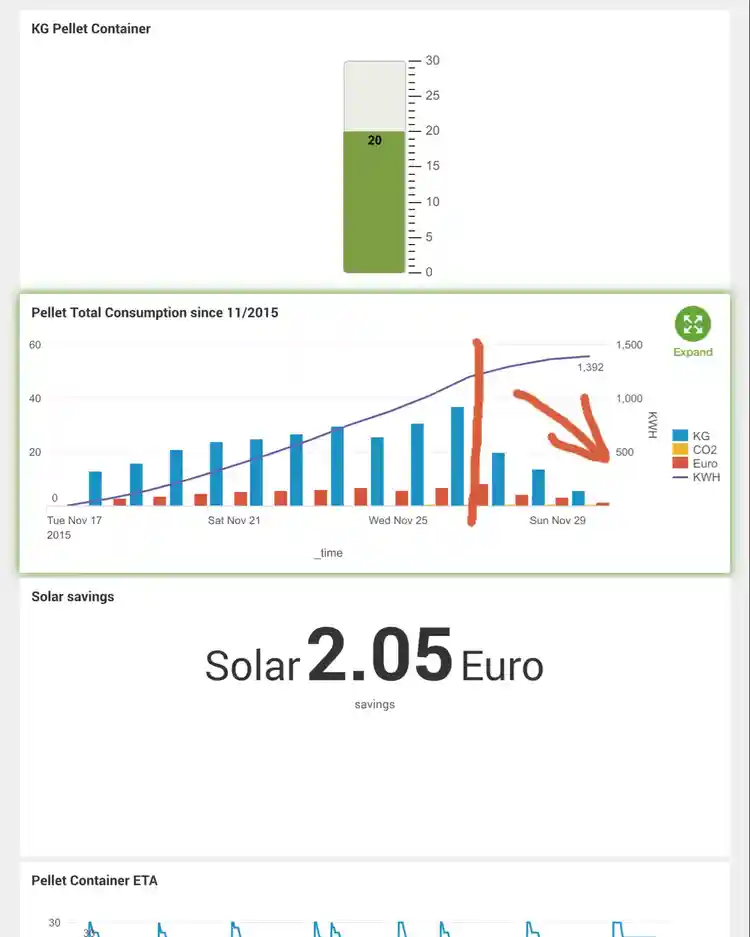

To find the cause of this problem, I checked the underfloor heating controls and reviewed the settings such as temperature, but couldn’t find any obvious problem. We also have a central ventilation unit with heat recovery and EC-technology from Helios in our house. Just to be sure, I reviewed the configuration for this and found my answer. In the Summer I enjoyed the experience of having fresh air circulating throughout the house for several hours everyday at full fan speed. Having found that this remained the same in the winter, I adjusted the settings down to a level that should be enough to keep the house fresh, but without the need to open windows regularly in the cold weather.
Observing the change
Having changed the configuration I monitored the situation through the Splunk Dashboard I created over the following days. I used my iPAD to show the data through the Splunk app, allowing for a full view of the dashboard. Having made the adjustment to the ventilation system I saw that my pellet consumption was reduced by about half. And that’s all the result of making machine data accessible, available and usable for everyone!
As you might recognize, I also made my calculations based on the KWH that the solar heating system produces, how many pellet’s I saved and how much that was in Euros.
When looking at how much this exercise saved me I worked out the following figures:
- €600 in pellet costs
- €530 in costs avoided by not purchasing legacy ETA pellet software
