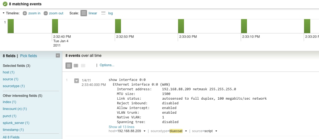

If everything works, you should have the output coming straight into Splunk, just like these screenshots.
Working on it, we were able to build dashboards that are important to the user.
