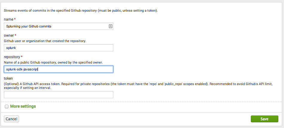

  1. From Splunk Home, click the Settings menu. Under Data, click Data inputs, and find “GitHub commits”, the input you just added. Click Add new on that row. splunk inputs
  2. Click Add new and fill in:
    • name (whatever name you want to give this input)
    • owner (the owner of the GitHub repository, this is a GitHub username or org name)
    • repository (the name of the GitHub repository)

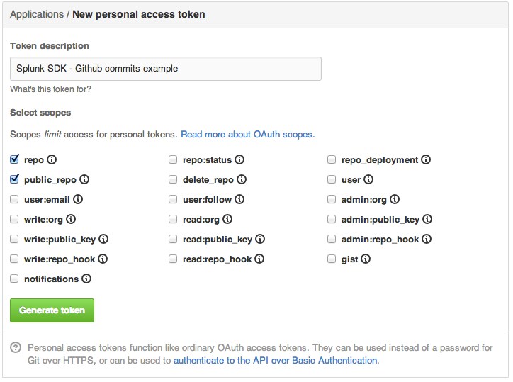

    • (optional) token if using a private repository and/or to avoid GitHub’s API limits
    splunk add inputTo get a GitHub API token visit the GitHub settings page and make sure the repo and public_repo scopes are selected. github token
  3. Save your input, and navigate back to Splunk Home.

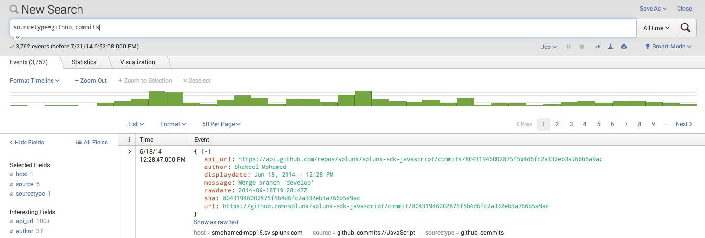

  4. Do a search for sourcetype=github_commits and you should see some events indexed; if your repository has a large number of commits indexing them may take a few moments.splunk search

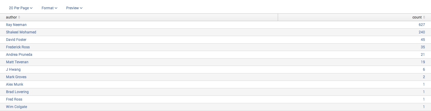

  • Want to know who the top contributors are for this repository? Run this search:
    sourcetype="github_commits" source="github_commits://[your input name]" | stats count by author | sort count DESC

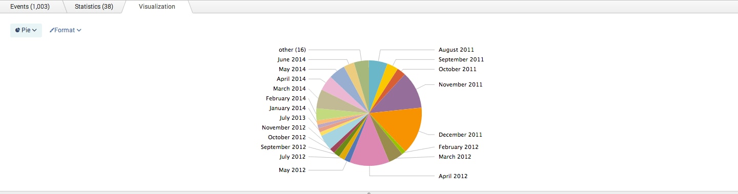

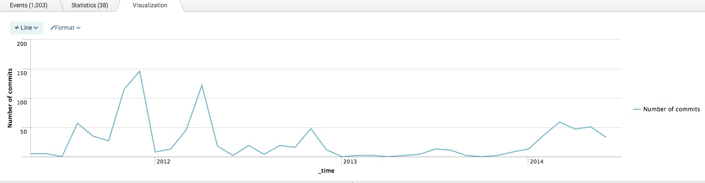

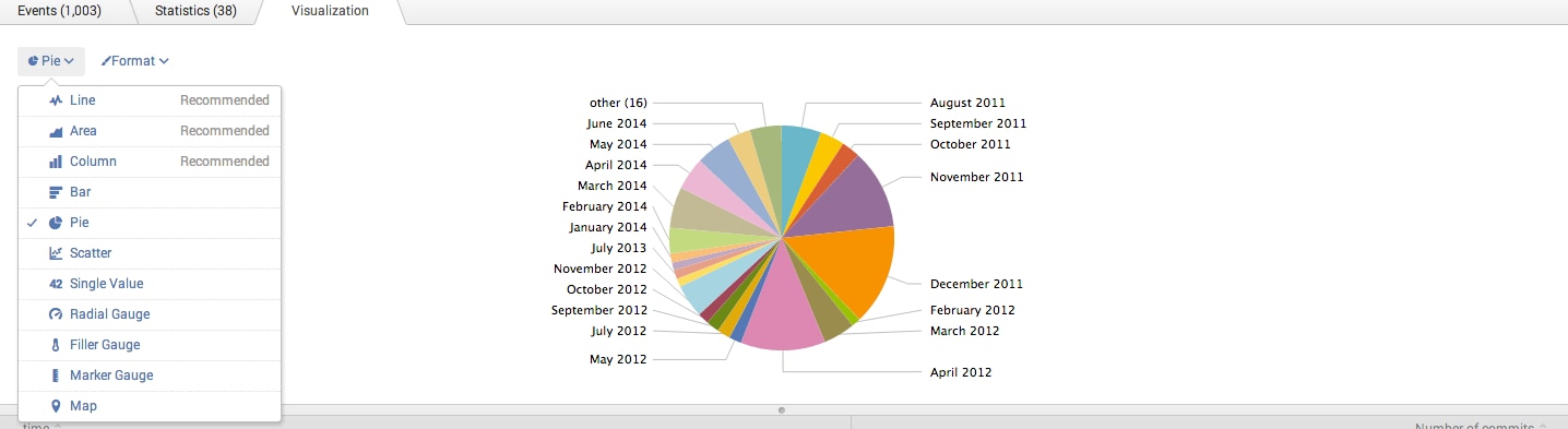

  • Want to see a graph of the repository’s commits over time? Run this search:
    sourcetype="github_commits" source="github_commits://[your input name]" | timechart count(sha) as "Number of commits"
    Then click the Vizualization tab, and select line from the drop down for visualization types (pie may be already selected).splunk viz 1splunk viz 2Splunk viz 3

  • token: A GitHub access token with at least the repo and public_repo scopes enabled. To get an access token, see the steps outlined earlier in this post.
