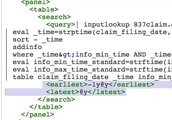

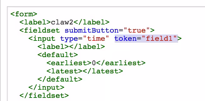

Finally there are two things we have to do with the panel to make it work so click edit source. screenshot156
We are going to provide the time evaluation in our where clause so we don’t need the token=”field1″ statement. So remove this…….
screenshot155
Next, we need to remove the earliest and latest clauses from just after the query.
That’s it save the changes and enjoy the results.

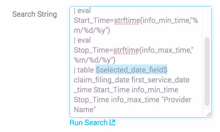

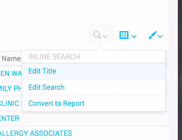

Now we need to add the Radio Button variable to the search string. Click Edit Search like this.
You can see where I have inserted $selected_date_field$. This is the magic sauce which will choose the field to use for the Time Picker.
screenshot171
Also notice that I we added the new fields and values to the report to make it easier to understand what the Panel is doing.

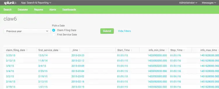

So this should look something like your very own masterpiece.
Splunk finished time picker start button
That’s it, now you can sort on any time field you have and use it for the time pickin anytime and anywhere you want.
