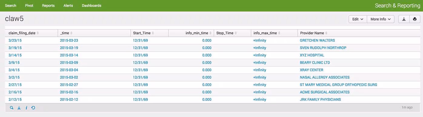

For the purpose of this demonstration, we need to format the output to make it easier to understand the results.
| eval Start_Time=strftime(info_min_time,"%m/%d/%y")
| eval Stop_Time=strftime(info_max_time,"%m/%d/%y")
| table claim_filing_date _time Start_Time info_min_time
        Stop_Time info_max_time "Provider Name"
That’s it, now you have a working search, try it with your data………

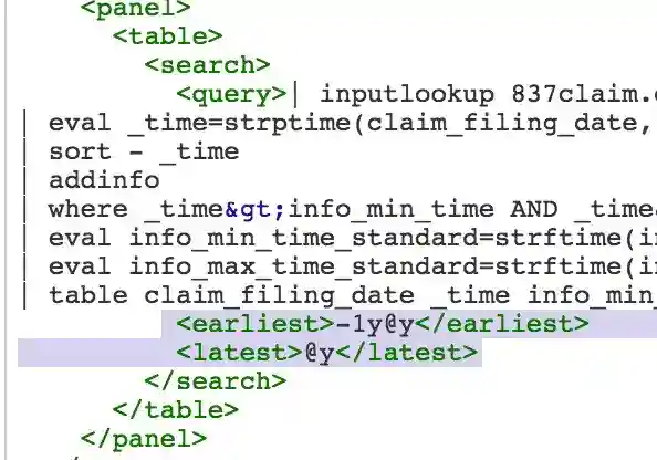

Finally there are two things we have to do with the panel to make it work so click edit source. screenshot156
We are going to provide the time evaluation in our where clause so we don’t need the token=”field1″ statement. So remove this…….
screenshot155
Next, we need to remove the earliest and latest clauses from just after the query.
That’s it save the changes and enjoy the results.

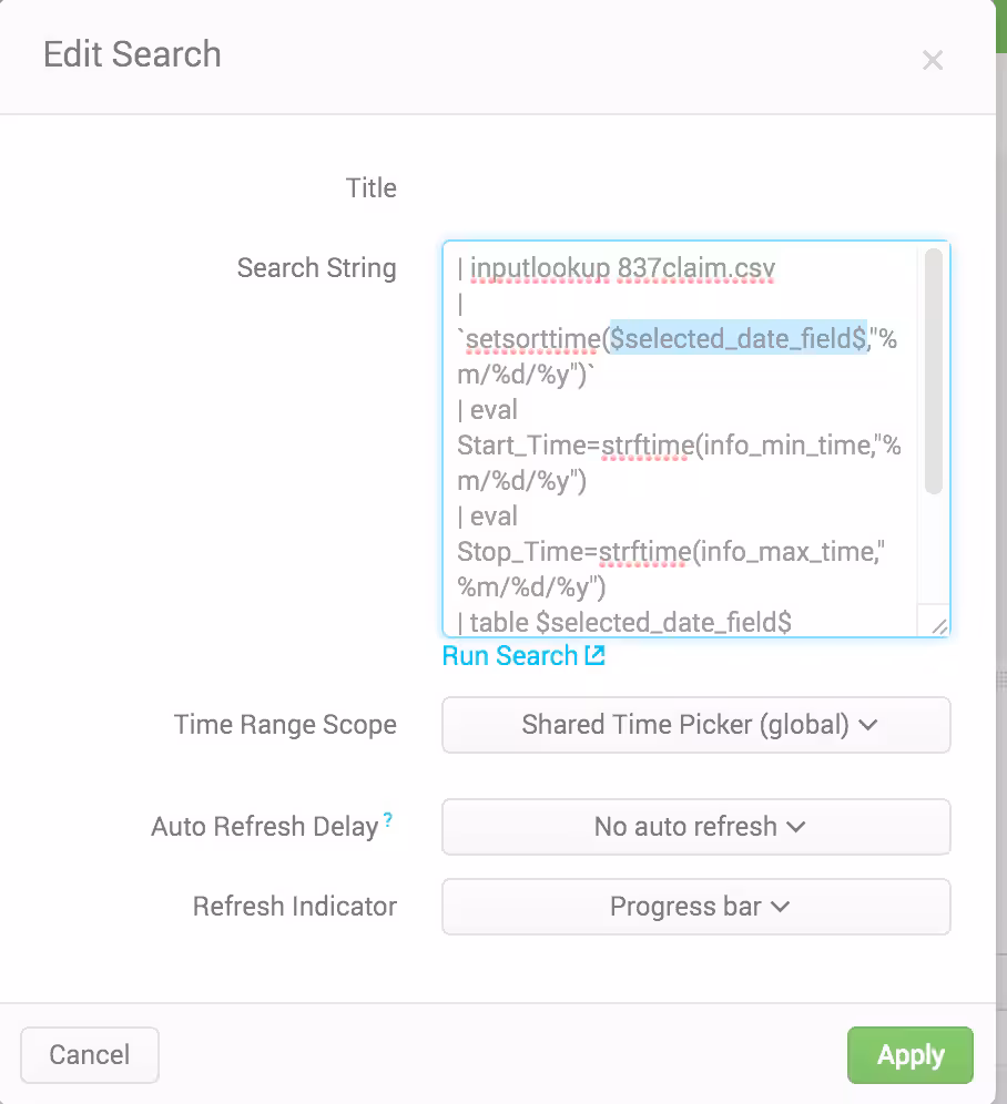

Good, you’re doing great. Now maybe you would like to add a Radio Button to allow you to pick the field you want to sort on.
screenshot165

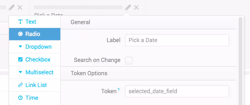

In the panel editor, add a drop down and let’s give it a Label of “Pick a Date” and a Token Name of selected_date_field.
screenshot167

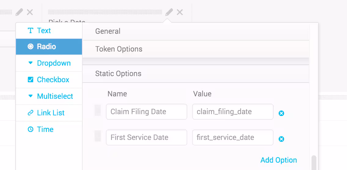

Now we can add a few fields to select from. Note that we are simply adding field names and a pretty description of each field.
screenshot168
screenshot169

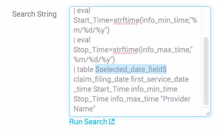

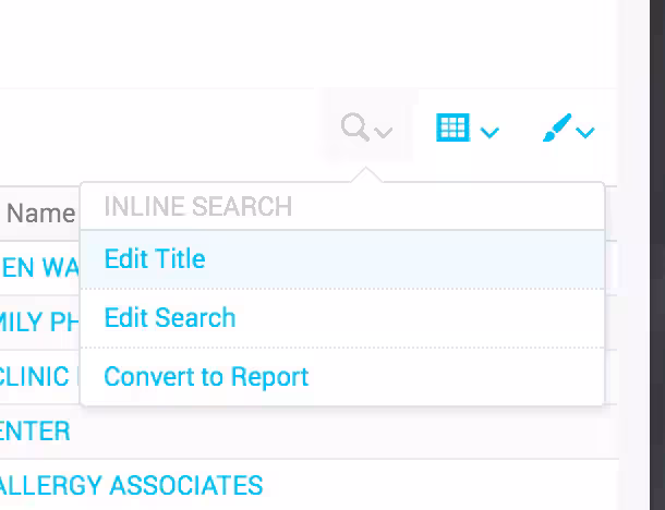

Now we need to add the Radio Button variable to the search string. Click Edit Search like this.
You can see where I have inserted $selected_date_field$. This is the magic sauce which will choose the field to use for the Time Picker.
screenshot171
Also notice that I we added the new fields and values to the report to make it easier to understand what the Panel is doing.

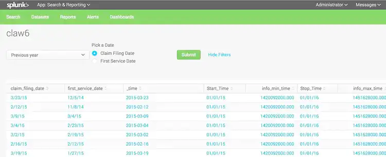

So this should look something like your very own masterpiece.
Splunk finished time picker start button
That’s it, now you can sort on any time field you have and use it for the time pickin anytime and anywhere you want.
