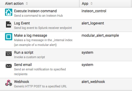

Deploy this onto a Splunk box and restart it. Then, navigate to “Alert actions” in the “settings” menu at the top right of the Splunk web UI. You should see your alert action listed (look for “Make a log message”):

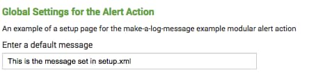

Step 5: make a setup page to set global defaults (optional)
Optionally, you can create a setup.xml page that sets default values for the Modular Alert. This useful for configuration items such as authentication which you may not want to have repeated for every instance of the alert action. This can also be used to modify the default values presented when configuring a modular alert.
To make a setup page, create a file named “setup.xml” in default/setup.xml. This results in the following file-structure:

Deploy this onto a Splunk box and restart it. The Alert Action list in the Splunk’s Manager will now show a link to your setup page (see the link titled “Setup Splunk Modular Alert Example”):
If you click the link to setup up the app then you will be taken to the setup page. I modified the default message to be “This is the message set in setup.xml”:
If you save the change, then Splunk will set the default value to whatever you defined. This deploys a local version of alert_actions.conf (in /modular_alert_example/local/alert_actions.conf) which includes the following in the example above:
[make_a_log_message]
disabled = 0
param.message = This is the message set in setup.xml
Once the default is change, any new alert actions will have this value in the message field by default. If I create a new instance of the alert action, I see the message field is already populated with the value I set above:
