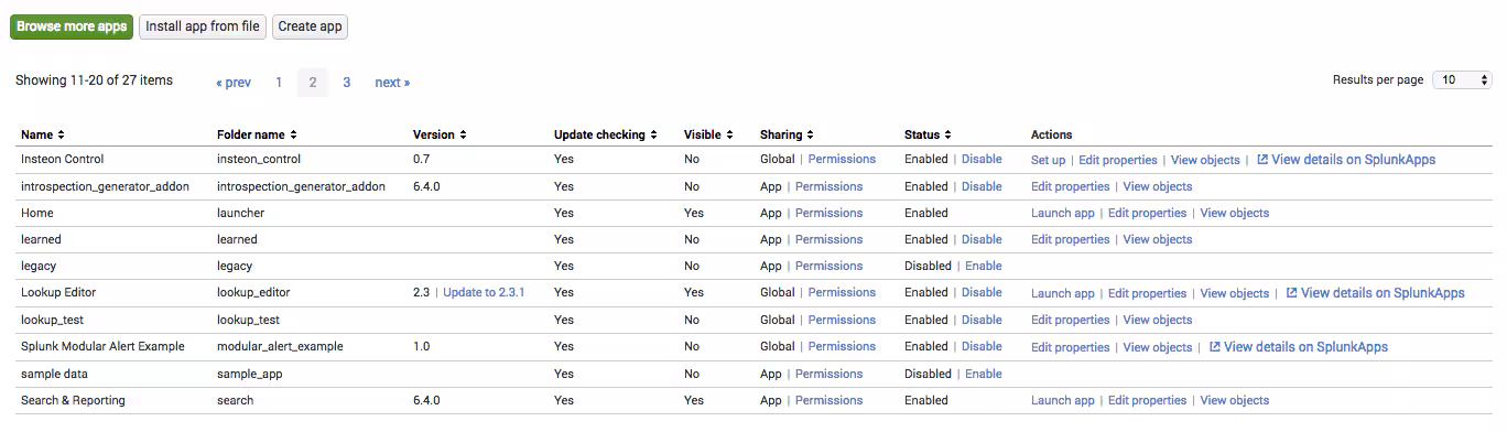

Deploy this onto a Splunk box and restart it. Once you do, you should see the app listed in the list of installed apps (look for “Splunk Modular Alert Example”):

Deploy this onto a Splunk box and restart it. The Alert Action list in the Splunk’s Manager will now show a link to your setup page (see the link titled “Setup Splunk Modular Alert Example”):
If you click the link to setup up the app then you will be taken to the setup page. I modified the default message to be “This is the message set in setup.xml”:
If you save the change, then Splunk will set the default value to whatever you defined. This deploys a local version of alert_actions.conf (in /modular_alert_example/local/alert_actions.conf) which includes the following in the example above:
[make_a_log_message]
disabled = 0
param.message = This is the message set in setup.xml
Once the default is change, any new alert actions will have this value in the message field by default. If I create a new instance of the alert action, I see the message field is already populated with the value I set above:
