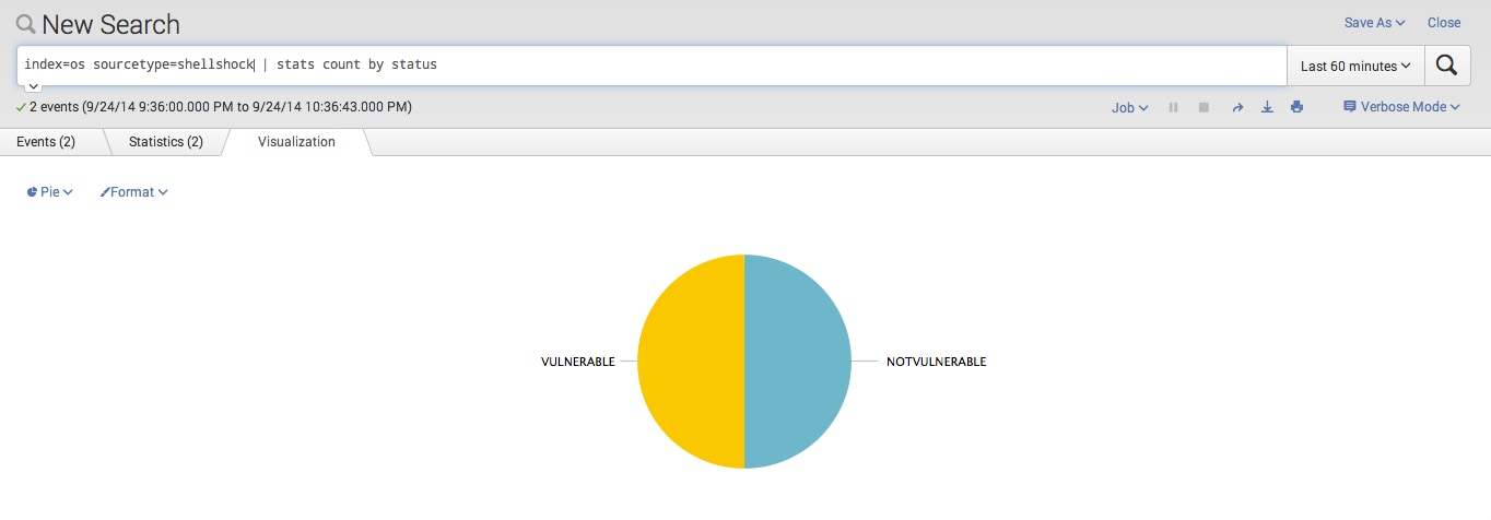

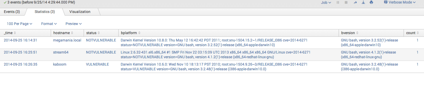

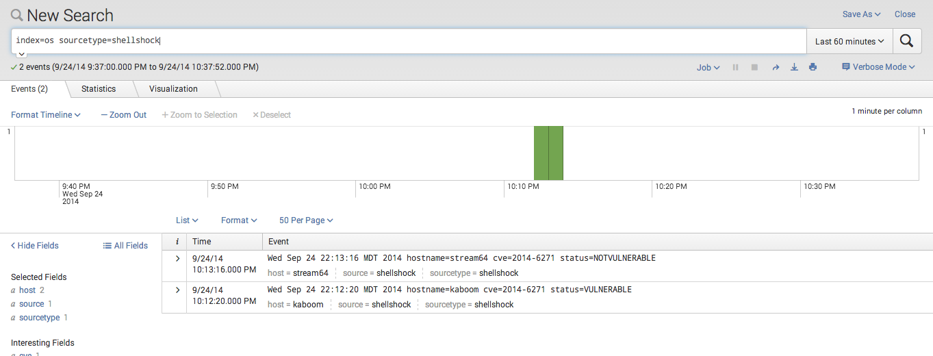

You can now search for any hosts with sourcetype=shellshock, and of course use the field “status” to determine if the host is vulnerable or not, and with the “platform” field and “version” field you can filter on various OS versions and levels (you may need to adjust the field extractions depending on what you end up with in your versions and platforms…). The middle screenshot below shows that I’ve patched a Linux box and an OSX box in my lab, but one remains unpatched (because showing all OK is never fun for examples!)

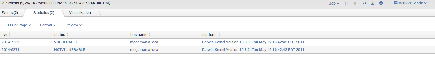

Search output from BOTH scripts above, showing that the freshly-compiled bash on my test OSX host is not vulnerable to 2014-6271, but is still for vulnerability 2014-7169:
