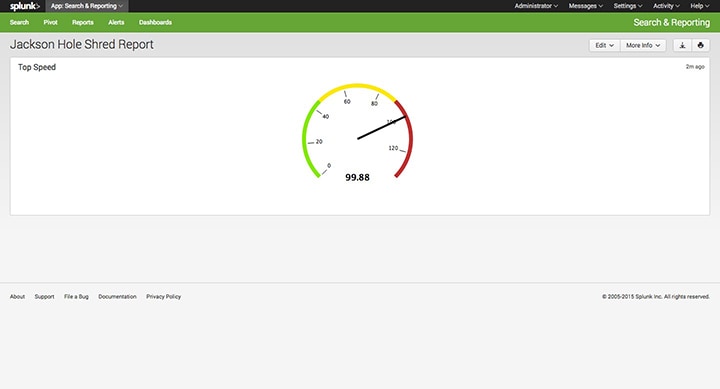

Top speed
The first thing I wanted know was, obviously, top speed.
<distance search>
| eval speed=distance/(duration/60/60)
| stats max(speed) AS maxSpeed
| eval "Max Speed kph"=round(maxSpeed,2)
| fields "Max Speed kph"
In the search above we do a simple speed calculation, and then use stats to find the max value.
Haversine calculates distance by default in Kilometers, hence Kilometers per hour is the output unit.

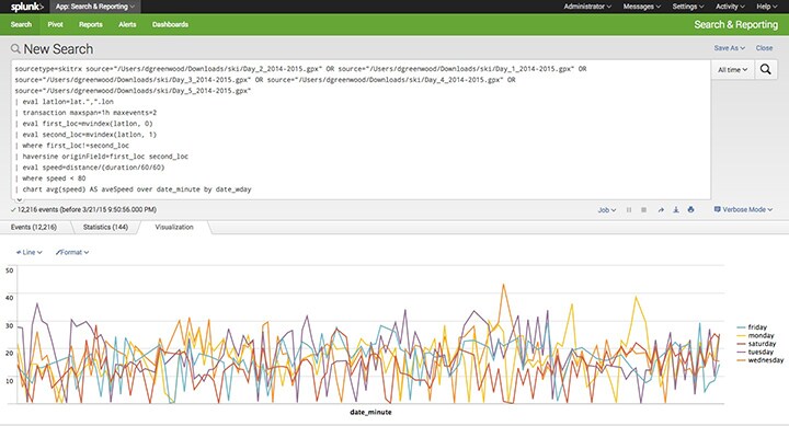

Keeping with speed, I then wanted to look at speed over time during the week – was I faster on a particular day?
<distance search>
| chart avg(speed) AS avgSpeed over date_minute by date_wday
In this search we again calculate speed and use a chart command to overlay each day on a single 24 hour time series graph (with minute granularity) so that we can easily compare them.
