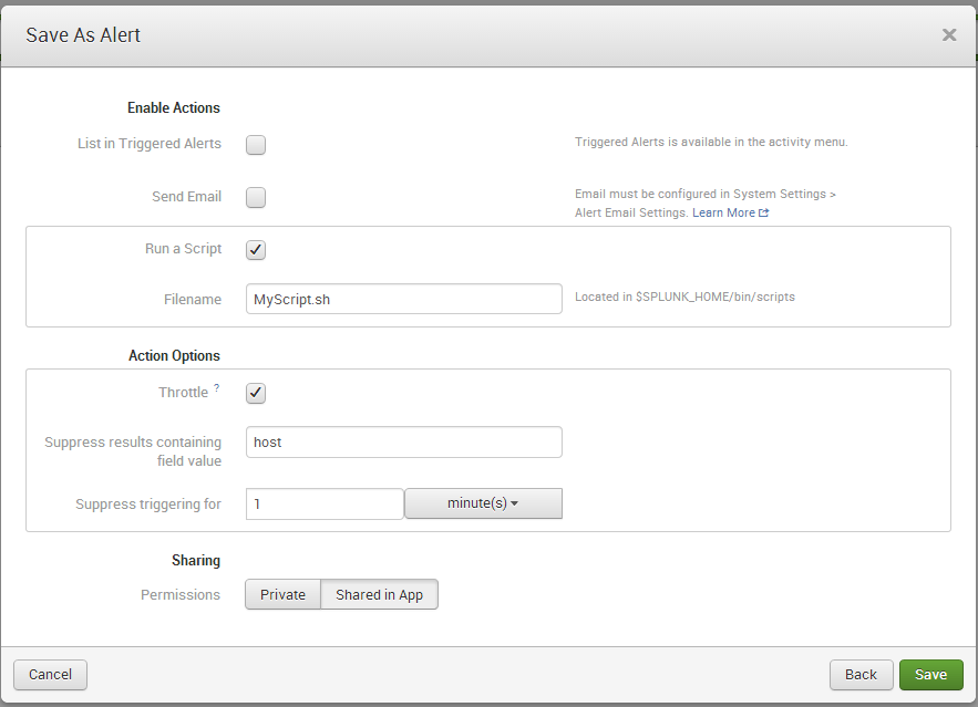

With that search created, I can go one of three ways. The first is by launching a script, by setting up an alert on the search. What may seem counter-intuitive to some is that Splunk does not pass the results of the search directly to the 3rd party script. What it does do is passes the location of the results, which can be accessed by either reading the file that the results are stored in, or by accessing the saved search via the API.  You can read more about that here.
Ideally, you would create a tiny script that will read the results from Splunk by accessing the search (and it’s results) via the API, parse the information, and then pass the extracted data to your 3rd party system API.
An alternative for this approach is to use a script that captures the file location on the Splunk server, and then parses through that file(s), and performs a for_while loop on each result.
