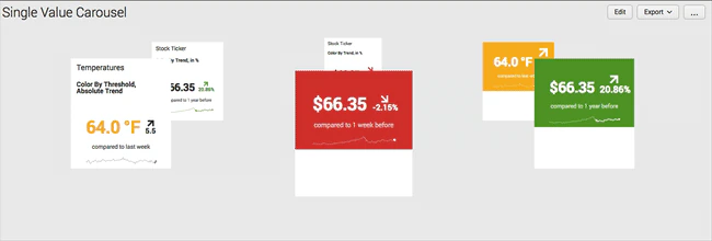

Fast forward to today.  Thinking back on that carousel, I wondered if I could create something similar in Splunk.  After all, SimpleXML renders to HTML and JavaScript in the end.  My thought was, "what if we can make Single Value visualizations spin around?  That could actually be useful in a NOC."  So, I set out to find a JavaScript library that could do this (which I did find), and wired it up to the dashboard.  It was shockingly easy to do.  Here is the end result:

First, create a dashboard that has a row of Single Value visualizations.  I borrowed some visualizations from the Dashboard Examples app.  The important part of the dashboard XML is adding the JavaScript and adding an ID to the row as seen below:
<dashboard stylesheet="carousel.css" script="carousel.js">
    <label>Single Value Carousel</label>
        <row id="showcase">
The full text of the dashboard can be found here -> https://github.com/JasonConger/mte_visualizations/blob/master/app/mte_visualizations/default/data/ui/views/carousel2.xml

    var showcase = $("#showcase");
            showcase.Cloud9Carousel( {
            …options…
Notice the $("#showcase") part which finds the element with an ID of "showcase" – that finds the row of Single Value visualizations.
Next, we just let the Cloud9Carousel JavaScript library do its thing.  There are several options you can set.  Check out the source of carousel.js to see all the options I used.  https://github.com/JasonConger/mte_visualizations/blob/master/app/mte_visualizations/appserver/static/carousel.js
