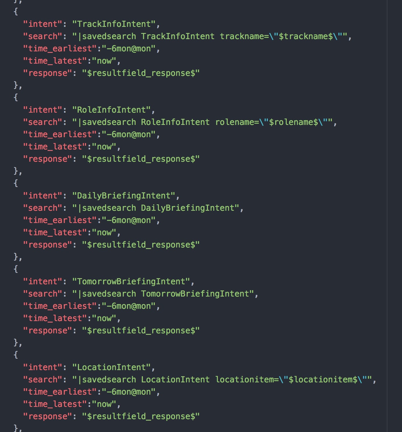

  • Mappings – This is a special json file that lives in the app where you can map intents to Splunk queries. This lets you pass the variables (from slots) as tokens to your Splunk search, define time ranges for search, and determines how and which field(s) in the search results gets passed back as the response from your Echo device.

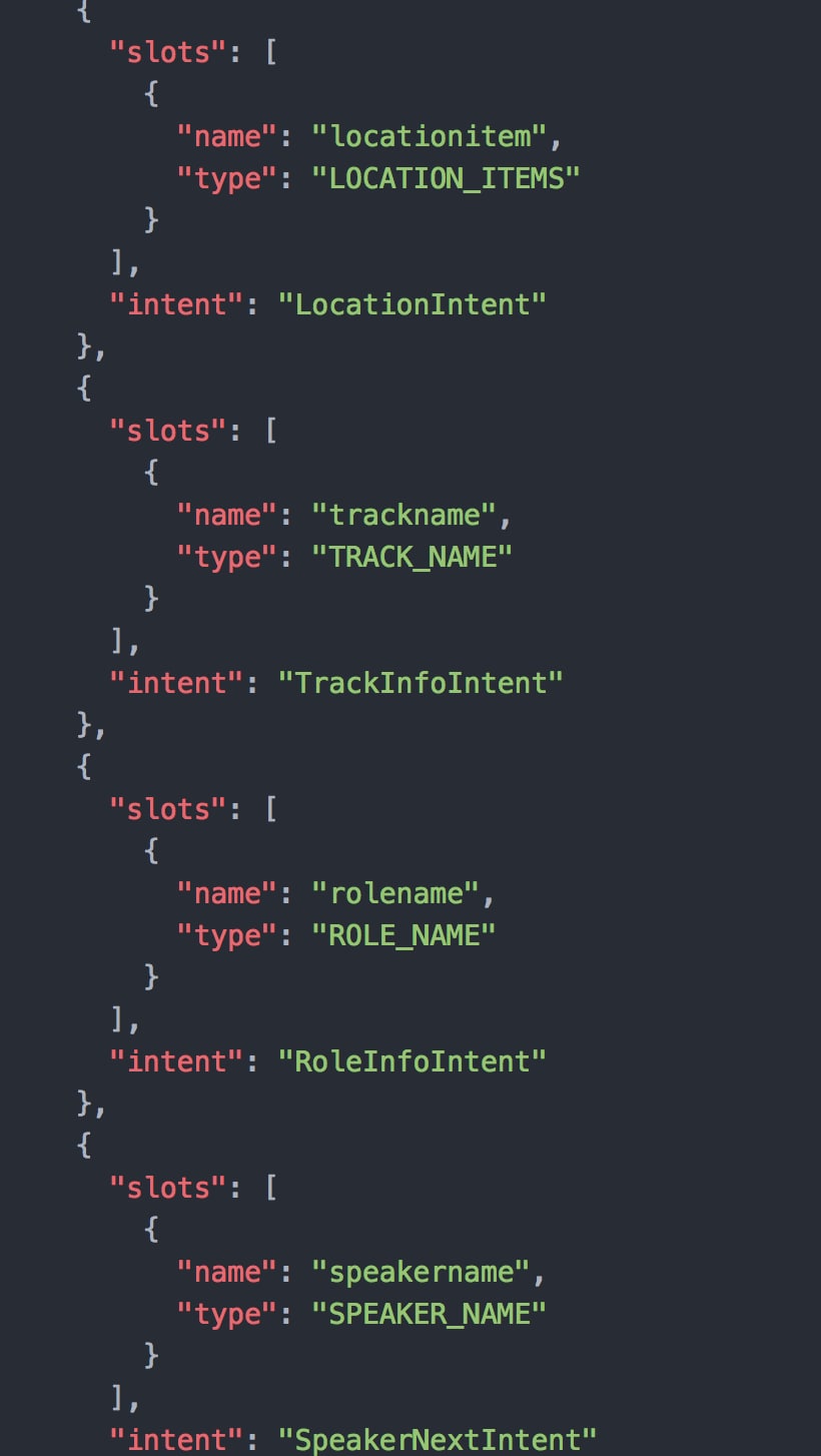

Step 1: Edit the intent_schema.json file from the app to define the new intent and any associated slots, if any.
Step 2: If the intent uses custom slots (e.g. speaker names), create a list of possible values (e.g. every speaker name).

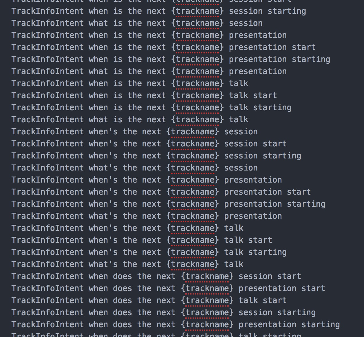

Step 3: Create a list of utterances to go along with the intent. This part will require you to think of every possible way someone might ask the same question and list it out. Be sure to include a placeholder for any custom slots in the utterances.
Step 4: Create a Splunk search that returns the correct response for the intent. You can pass slot values to the search and pass field values back through the search results. Once you’ve got this figured out and tested, you can either save the search and configure the app’s mapping.json file to use the saved search, or you can put the search itself into the mapping.json file.

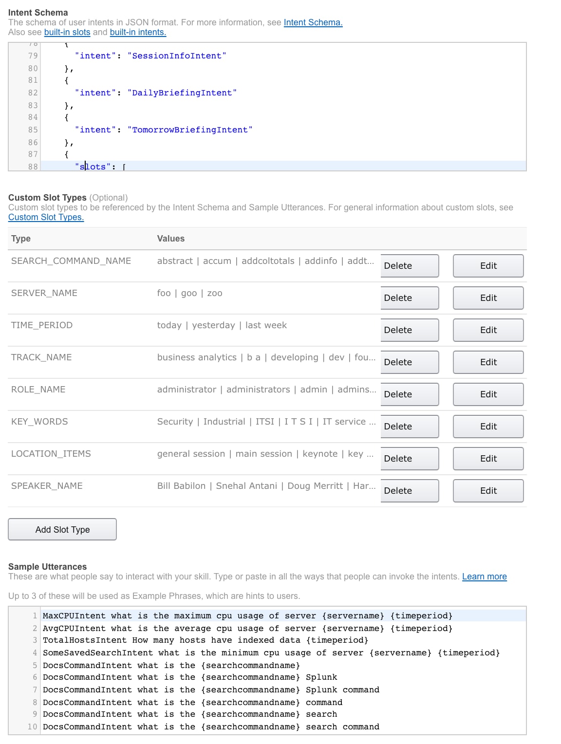

Step 5: Lastly, you need to edit the Interaction Model of your Alexa skill on Amazon’s developer portal with the new intent schema, custom slots, and utterances. This is most easily accomplished through some cut and paste from the files in the app’s alexa_assets directory.
Test everything out from the developer portal test page, or run it through your actual Echo device. If it works as expected, you’re good to go; otherwise, check syntax and typos until you’ve got it figured it out.
