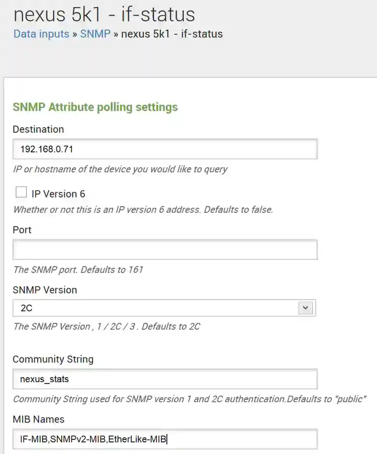

SNMP Configuration Screen
You can configure SNMP inputs directly in the Modular Input’s management pages, or you can write config stanzas. In my case, because I hadn’t worked with this Modular Input before, I configured one via the UI, and then copied it and edited it to configure all the other devices I needed to monitor.
Here is the configuration I used for each device: two stanzas, one for the config data which was collected every hour, and one for the performance statistics which was collected more frequently (in the examples below, every 5 minutes). Note that you have to list the MIBs that will be loaded for parsing the data, and the community string, and give each stanza a name that will help you identify it when you see it in the logs.
