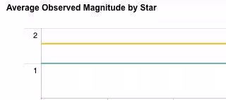

For instance, suppose, we have the following data
Fri May 21 22:34:40 EDT 2010 star=n14532 1.01 Fri May 21 22:35:40 EDT 2010 star=n14532 1.00 Fri May 21 22:35:40 EDT 2010 star=n32344 1.62 Fri May 21 22:36:40 EDT 2010 star=n14532 0.99 Fri May 21 22:37:40 EDT 2010 star=n32344 1.60 ...
The last number in each series represents the observed magnitude (an object’s brightness) of different stars in this computer generated log file. I could index this data into Splunk and plot the relative average observed magnitude by star with a simple search command.
sourcetype=starlog|timechart avg(observed_magnitude) by star
This would end up looking something like this:

With two stars and very few events, this isn’t terribly exciting. However, from real calculations, with billions of galaxies and trillions of stars, the volume of data becomes challenging to manage and our simple time chart search command becomes a handy mechanism to analyze and plot the graph in the same manner.
