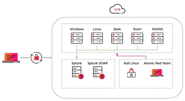

What Is Splunk Attack Range?
Splunk Attack Range builds instrumented cloud environments on AWS, Azure, or GCP. You get a small, production-like lab: a Splunk instance, Windows and Linux servers, optional Kali for red-team style testing, Zeek for network visibility, Active Directory–style layouts, and more - all provisioned with Terraform (infrastructure) and Ansible (configuration). The range can simulate attacks (e.g. via Atomic Red Team) against chosen targets; the resulting telemetry (logs, events, network data) is forwarded into Splunk so you can develop, tune, and validate detections in a safe, isolated environment.
In short: build labs → simulate attacks → use the telemetry in Splunk for detection development and testing.
Typical use cases include building new Splunk detection content, testing existing rules, running purple-team exercises, and automating detection tests in CI/CD. Because the lab is created from templates and accessed only over a VPN, you avoid exposing lab systems on the public internet and keep your detection workflow consistent across teams and clouds.

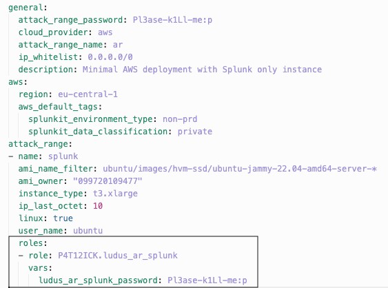

Use Any Ansible Galaxy Role
Templates define which Ansible roles run on each server. Attack Range installs every role you list (via ansible-galaxy install) and runs them at build time in the order specified. You can use any Ansible Galaxy role - not only the ones shipped with Attack Range. Use the Galaxy role name as on Ansible Galaxy (e.g. namespace.role_name like P4T12ICK.ludus_ar_splunk or geerlingguy.nginx). In the template you can list a role as a string or as a dict with role and optional vars (and inventory_name if the role expects a specific host group). Example:
To add a custom Splunk app, monitoring, or security tool: copy a template, add the Galaxy role to the right server’s roles list (with vars if needed), save, and build from that template. No Attack Range code changes are required; the controller scans the config for all role names and runs ansible-galaxy install for each before executing the generated lab playbook.
