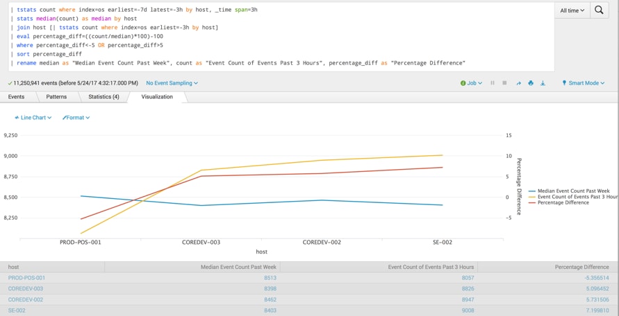

With that gentle warning, let’s build a search to quickly identify hosts that are logging more or less data than might be normally expected. Placing boundaries on the data — even when it is coming from a large number of hosts — can be easily done.
For this search, I am looking at hosts logging to the index ‘os’ and I want to look back over the past seven days in carving the time in 3-hour intervals to find the median count of events by host. Statistical options that might be appropriate to use here:
I then looked back over the past 3 hours for the same information. To determine the percentage difference between the median and the current count, we divided to get a percentage value and filtered for results +/-5%. Sorting and renaming fields makes it easy to consume since I now have my outliers, as well as producing a graph that shows the median and the current event volumes charted along with the percentage difference.
