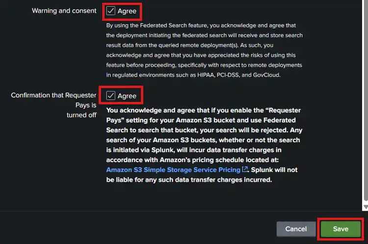

12. Now that we have setup the permissions of Splunk, tick both the agree buttons and Click Save:
This should now have created a federated provider. Let’s now create our federated index for AWS WAF logs.

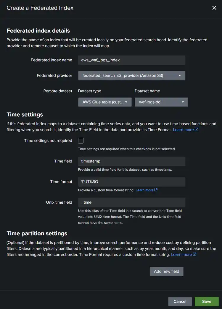

Set Up a Federated Index
Select the federated indexes tab in Splunk
Click the Add federated index, followed by For S3 provider buttons.
Fill in the following fields to create an index:
- Federated index name: eg aws_waf_logs_index
- Select our new Federated Provider we created
- Dataset type: Make sure (customer created) is selected
- Dataset Name: Select our glue table name created earlier eg waf-logs-ddl
Fill in the following fields to Time Settings:
- Time settings not required: Leave unticked
- Time field: timestamp (this is the timestamp field from AWS WAF logs)
- Time format: %UT%3Q (this is UNIX time with millisecond format)
Sample screen shot with fields filled in:
Click Save when happy.

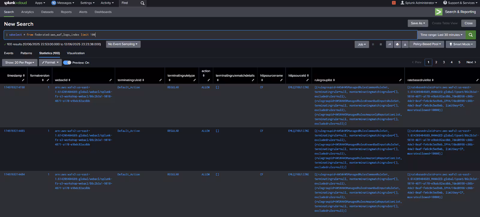

Running Basic SDSELECT Command Against AWS WAF Logs
- From your Splunk console, select Apps, Search and Reporting
From here we will interact with our Splunk Search Processing Language (SPL). - From your search bar, let’s try a simple search. Copy and paste the below SPL into the search bar and click search:
| sdselect * from federated:aws_waf_logs_index limit 100
Note: it may take a minute or two for the permissions to propagate properly. But after a minute or two you should hopefully see the following result as an example:
That’s it! You have now configured a connection between Splunk and AWS to search in place your AWS WAF Logs.
