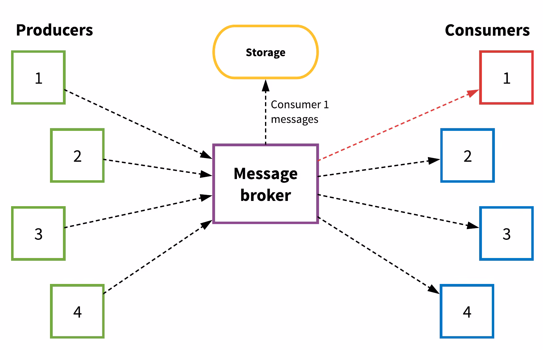

Figure 1 below provides a basic illustration of how message queues typically work (and respond to failure):
In this figure, producers 1, 2, 3, and 4 are busy pumping messages into the pipeline through the message broker, while consumers 1, 2, 3, and 4 process (and then acknowledge) those messages. In this example, a serious problem emerges when consumer 1 fails. Producers are continuing to pump data into the system but consumer 1 can't handle its tasks. What should happen is that the broker begins storing all message data intended for consumer 1 until it's again ready to process incoming messages.
We can see from this example that a rock-solid storage component is essential to any message queue worth having in your stack. In fact, I'm comfortable declaring that your message queue is only as good as the storage system that backs it. If the storage component is brittle, lossy, or too slow to cope with the failure of any number of components then you're practically begging for trouble.
