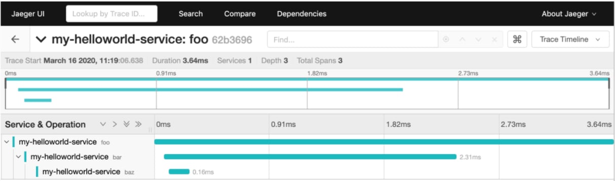

Run the following command to start Jaeger:
docker run -p 16686:16686 -p 6831:6831/udp jaegertracing/all-in-one
This command starts Jaeger locally on port 16686 and exposes the Jaeger thrift agent on port 6831. You can visit Jaeger here.
After you spin up the backend, your application needs to export traces to this system. Although opentelemetry-sdk doesn’t provide an exporter for Jaeger, you can install it as a separate package with the following command:
pip install opentelemetry-exporter-jaeger
After you install the exporter, update your code to import the Jaeger exporter and use that instead:
# jaeger_example.py
from opentelemetry import trace
from opentelemetry.exporter.jaeger.thrift import JaegerExporter
from opentelemetry.sdk.resources import SERVICE_NAME, Resource
from opentelemetry.sdk.trace import TracerProvider
from opentelemetry.sdk.trace.export import BatchSpanProcessor
trace.set_tracer_provider(
    TracerProvider(
        resource=Resource.create({SERVICE_NAME: "my-helloworld-service"})
jaeger_exporter = JaegerExporter(agent_host_name="localhost", agent_port=6831,)
trace.get_tracer_provider().add_span_processor(
    BatchSpanProcessor(jaeger_exporter)
tracer = trace.get_tracer(__name__)
with tracer.start_as_current_span("foo"):
    with tracer.start_as_current_span("bar"):
        with tracer.start_as_current_span("baz"):
            print("Hello world from OpenTelemetry Python!")
Finally, run the Python script:
python jaeger_example.py
