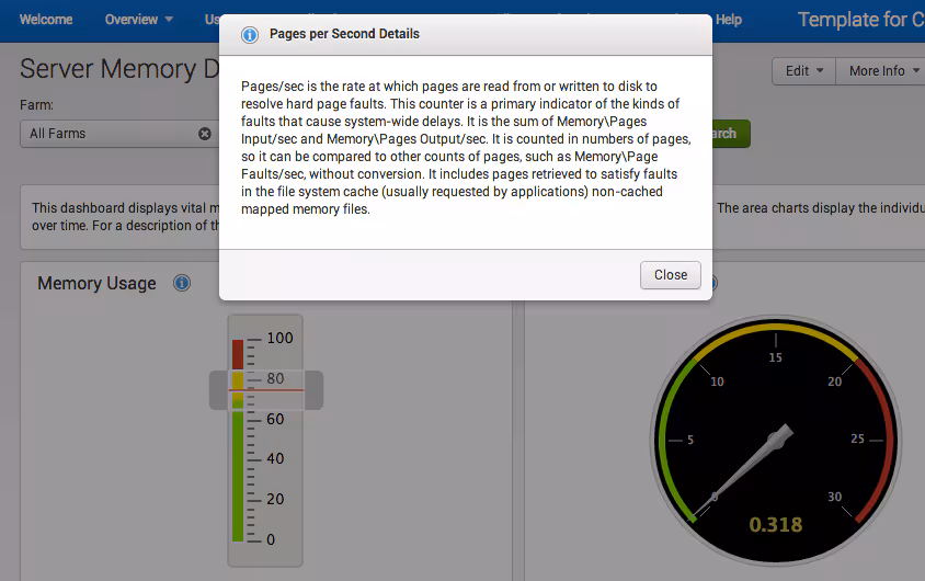

While working on a performance dashboard recently, I wanted an area to further explain the performance metric currently being displayed without taking up too much screen real estate. In the end, I ended up using a Bootstrap modal dialog to display the metric details when a user clicks an information icon. Here is the end result:
ModalDescription

The last step is to add some CSS to do things like float and add padding. The important part of the CSS is setting the .modal display to none. There is a bug feature in Chrome that will render controls behind the modal dialog useless even when the dialog is not displayed (reference -> http://updates.html5rocks.com/2012/09/Stacking-Changes-Coming-to-position-fixed-elements) To fix this, add the following to your stylesheet:
.modal { display: none; }
