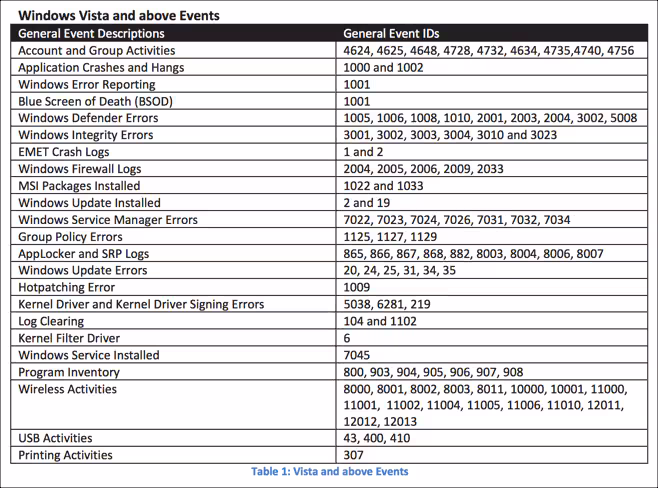

With that in mind, I thought I would take a moment and possibly give out some “Splunkspiration™” that I have shared several times over the last year but never committed to paper. For those of you who are not clued in by the vague title, the NSA IA team released a great white paper several years ago which was recently updated called “Spotting the Adversary with Windows event Log Monitoring” [2]. I highly recommend reading the entire white paper, but my favorite section is on page 8 where these beautiful IA nerds at the NSA provide a table of all the event codes that they find interesting for detecting baddies in your windows network.
So for those of you who are wondering what the hell to look for with those millions of Windows Logs… these Event ID’s are a great place to start!!! Since I’ve already done some of the work, I decided to share a little Splunk panel below that groups all of these Event IDs into selections based on the descriptions above. This does have the assumption that you have your GPO’s set up right to get these logs (see aforementioned NSA document), that you have the Windows Infrastructure app installed, and your CIM setup correctly. I’m not gonna lie to you. This panel is not going to find APT1337 right off the bat but it should give that bit of “Splunkspiration™” to go out there, make some correlation rules, add some saved searches, or go crazy on the SPL à la Splunker David Veuve, and get into the APT squashing business.
