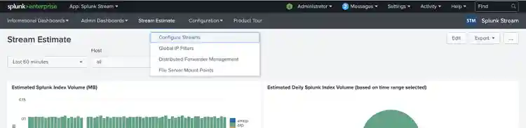

2) Navigate to the Splunk App for Stream, then click Configuration > Configure Streams.

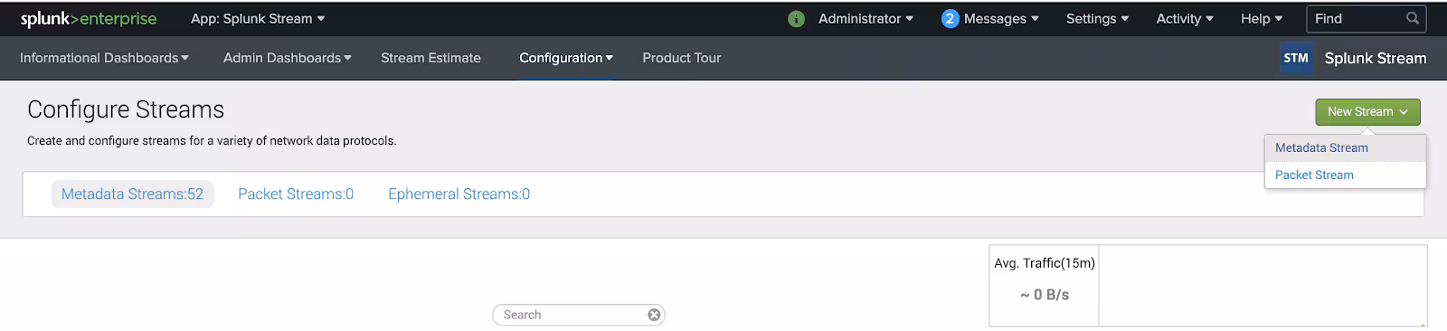

3) Click New Stream > Metadata.
4) Enter Name as netflow_test.
5) Select NetFlow as the protocol.
6) The NetFlow option works for NetFlow, sFlow, jFlow, and IPFIX protocols.
Enter a description then click Next.
7) Select No in the Aggregation box then click Next.
8) (Optional) Deselect any fields that do not apply to your use case then click Next.
9) (Optional) Develop filters to reduce noise from high traffic devices then click Next.
10) Select the index for this collection and click Enable then click Next. For example netflow_index (that you should have previously created)
11) Select the Default group and Create_Stream.

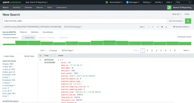

Finally check NetFlow data is being indexed at netflow_index we previously created:
