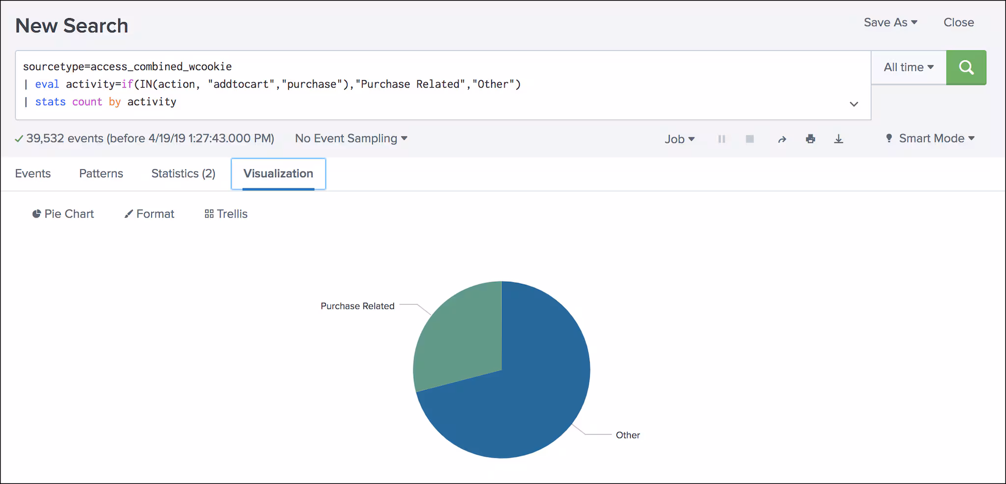

Let's go through an example where you can use the IN function as the first parameter for the IF function. We'll use the access.log file that is included with the Search Tutorial data.
In the following example, the IN function is used with the IF function to evaluate the action field. Then the stats command performs a calculation.
sourcetype=access_combined_wcookie
| eval activity=if(IN(action, "addtocart","purchase"),"Purchase Related","Other")
| stats count by activity
Here is what this search is doing:
- The eval command creates a new field called activity.
- If the action field in an event contains the value addtocart or purchase, the value Purchase Related is placed in the activity field.
- If the action field in an event contains any other value, the value Other is placed in the activity field.
- The stats command counts the Purchase Related and Other values in the activity field.
The results appear on the Statistics tab and show the counts for how many events have Purchase Related activity and how many have Other types of activity.
You can save this search as a dashboard panel or a report.
