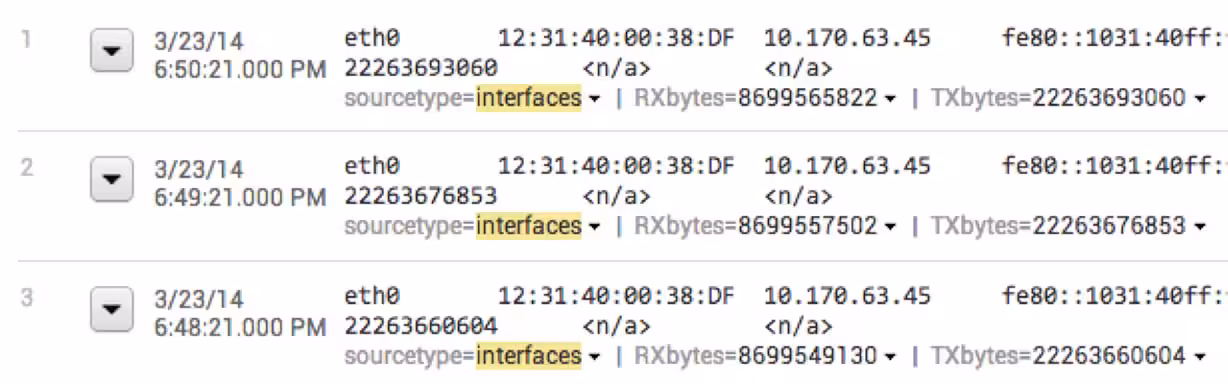

One common use of delta is calculating throughput when you have a cumulative total value in your events. For example, in the Splunk app for Unix the interfaces sourcetype has data like below.
Splunk interfaces searchtype data
You can see that RXbytes and TXbytes are the incrementing sum of bytes transferred on any given interface. If we want to calculate throughput, we just need to know the number of bytes transferred for a given period and divide it by the amount of time it took. Simple!
To calculate the difference, one method would be to use the delta command.
index=os sourcetype="interfaces" |reverse | delta RXbytes as rx_delta | delta TXbytes as tx_delta
