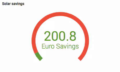

Throughout the course of the year the warm water solar system on top of my house helped provide additional warmth when the sun shined.
3_solar_heating_savings
Through this I saved 200.80 Euros over the course of the year. I spent about 3,000 Euros on the system – so you can see on the green/red range that we are going to need some additional sunny years to pay it of!
3_solar_savings_year

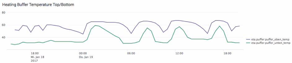

I played around with the settings and found out that the bottom sensor of the buffer storage was set to send a heat signal when it fell by 10 degrees – this is a configuration which makes sense in summer to consume as much as possible from the solar panels. It doesn’t however make sense in winter.
I made a configuration change to ensure that the sensor at the bottom of the heating buffer stops the heating up process when 50 degrees is reached so the buffer storage would be fully loaded each time.
Storage_Buffer_Temp
I could observe the problem at the beginning with a low temperature (green line) – and then after the configuration change we can see it fully loads at the top and bottom temperatures now.

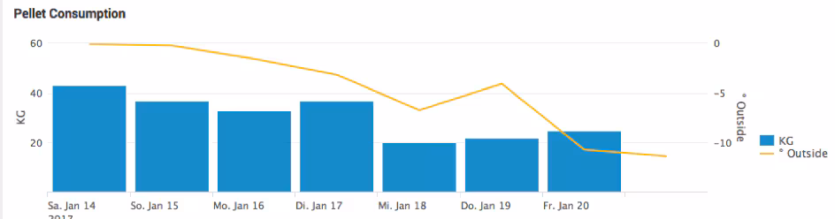

What about the pellet consumption now?
6 - puffer heating corrected
As you can see – until 20:00 the misconfiguration with constant heating start/stop was occurring with the system heating up just a little every time. At about 20:30 I made the configuration changes and in the next day you can see the heating storage can be utilised for far longer with fewer but more intensive heating cycles.
pellet-consumption
You can see that in the days before this change occurred more pellets were burned then in the most recent days – even if it became very cold with an average temperature of -10 degrees! It seems clear that the pellet unit needs a certain amount of pellet per burn to be effective, it doesn’t matter if you are heating up a little bit up or if you are heating up a lot.
