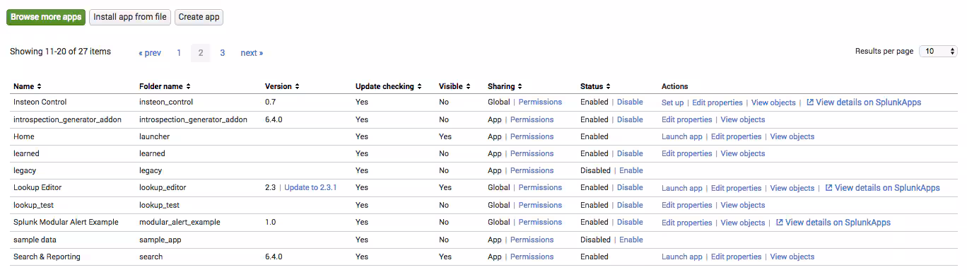

Deploy this onto a Splunk box and restart it. Once you do, you should see the app listed in the list of installed apps (look for “Splunk Modular Alert Example”):
Example app successfully installed
