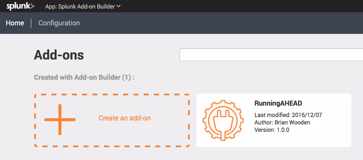

Click “Create an add-on”
Create Add-On

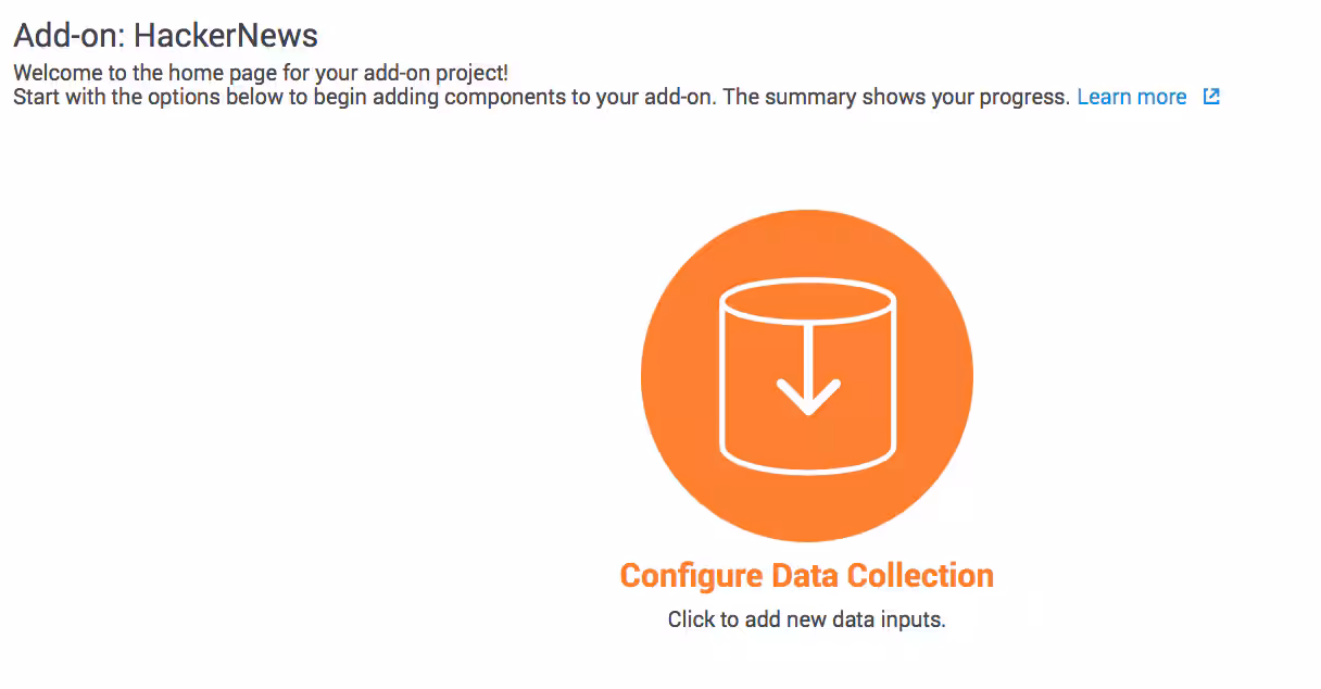

Now we’ll define the input. Follow the workflow to create a custom Python input (Configure Data Collection -> Add Data -> Modular Input Code)
Step 4.1
Configure Data Input
Step 4.2
Add Data
Step 4.3
My Python Code

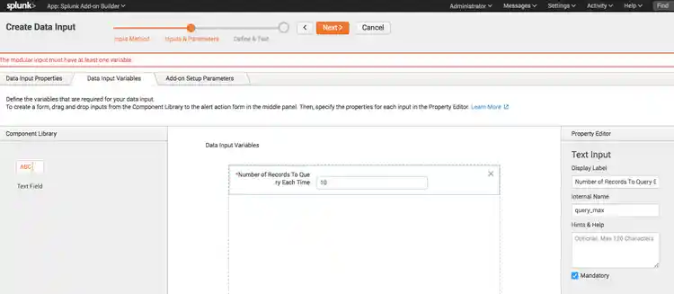

Next, data input variables are defined.
These are the per-instance variables configured in settings -> data inputs. There will be one of these for each user-configured input.
Generally this would be where user-specific information lives (e.g. API tokens, etc).
As this is a simple example, we will simply use “number of records to query each time” as a way to demo.
Data Input Variables

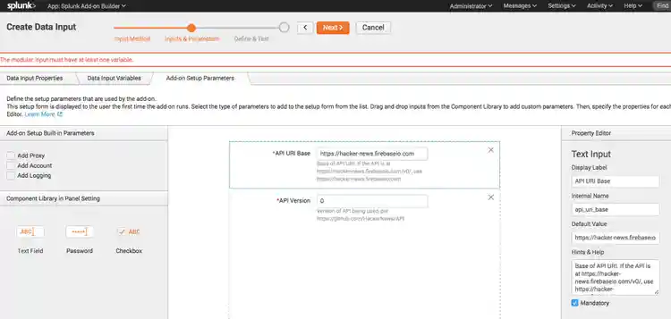

Finally, we’ll define the Add-on Setup Parameters. These are the global input parameters defined in the Add-on’s setup page. These will be the universal settings available to all inputs configured using this modular input.
In this example, we’ll specify an API base URI and the API version.

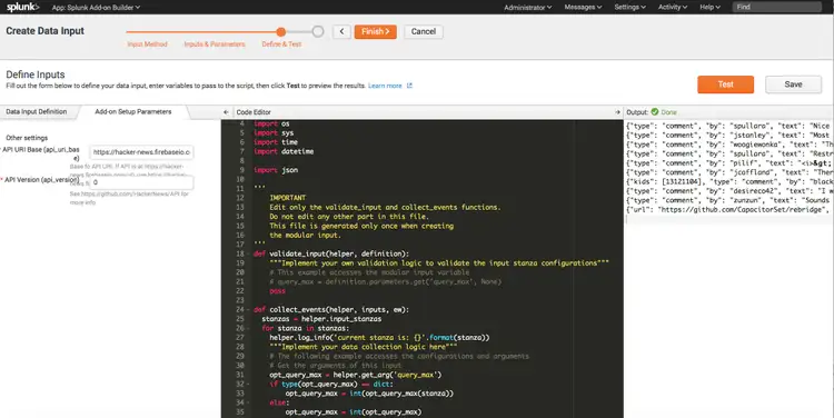

Step 9 – Entering test values
Now that we’ve copied pasta and modified for our own purposes, we can test!
Be sure to update the forms on the tabs Data input Definition & Add-on Setup Parameters to the left of the Code Editor to make sure test mode has parameters with which to work.
Code Editor Return to Table of Contents
Step 10 – Run Test
I suppose this could have been included in step #9. Run the test once you’ve entered the parameters on both tabs per step #9 by clicking on that Test button.
In AoB 2.0, events successfully written to Splunk will be displayed in Output window on the right hand side.
