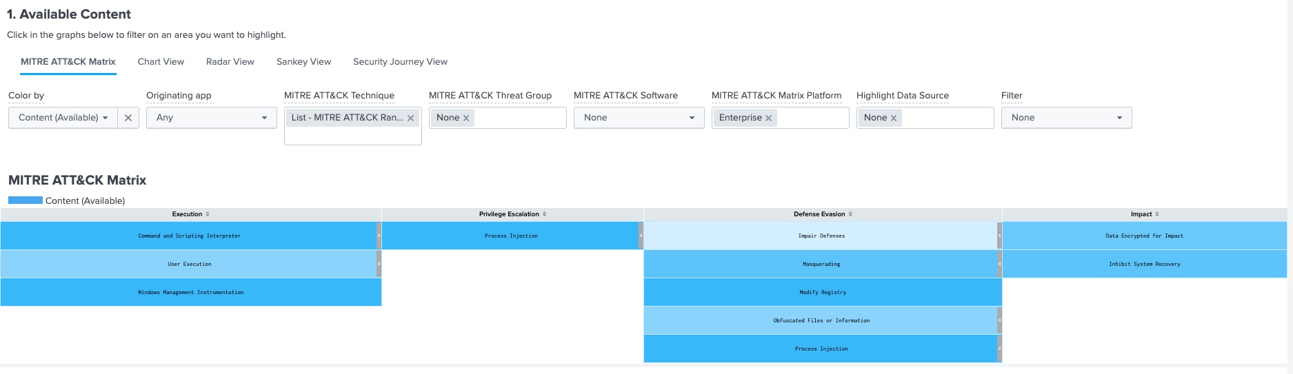

  1. Navigate to the Analytics Advisor -> MITRE ATT&CK Framework
  2. Select “List MITRE ATT&CK Ransomware Top 10” in the ATT&CK Technique dropdown above the ATT&CK Matrix
A subset of the ATT&CK Matrix showing the selected Techniques
The selected techniques and the coverage metrics in the current environment

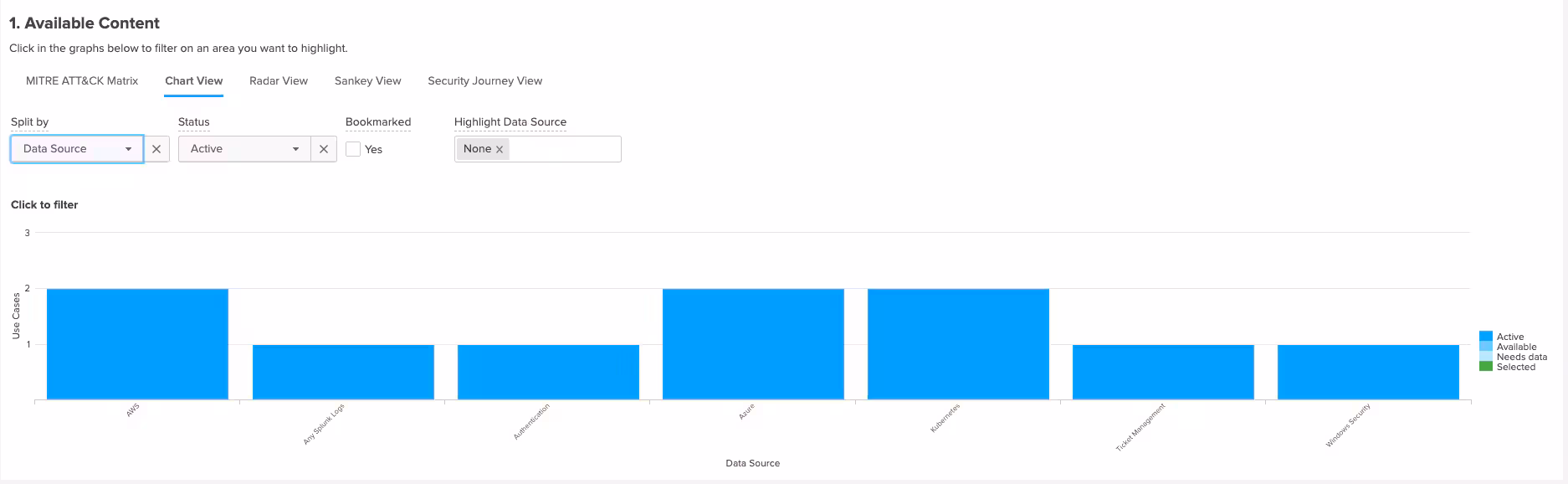

Which Data Source Is Providing Me With the Most Technique Coverage?
  2. Select the Chart View tab
  3. Select “Data Source” in the “Split by” dropdown
  4. Select “Active” in the “Status” dropdown

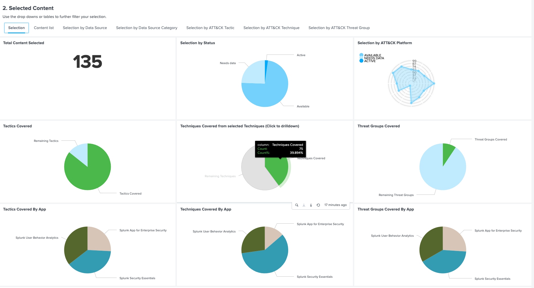

  1. Click the “Selection by Data Source” tab under the “Selected Content” section further down
The number of detections and other content available in Security Essentials split by data source.
