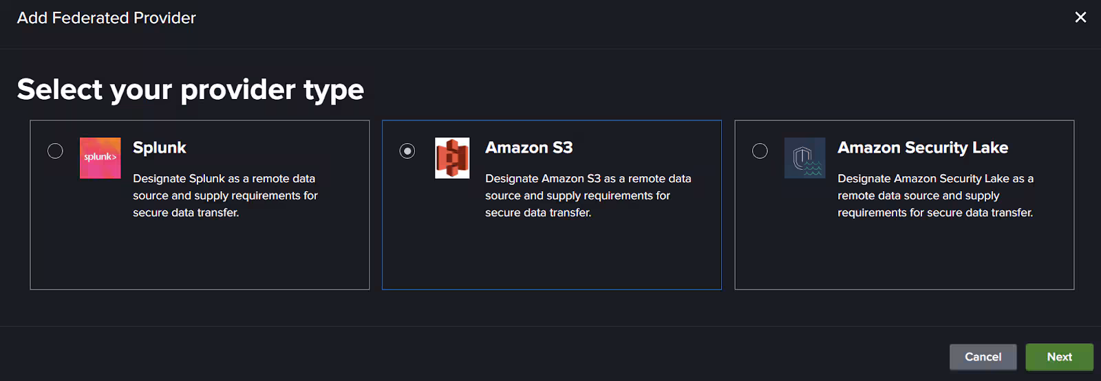

  3. Select Amazon S3 and click next:

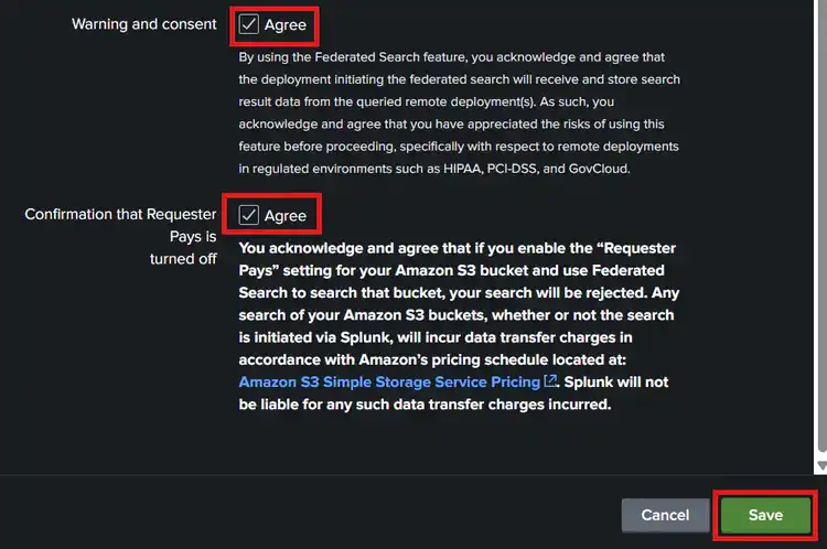

12. Now that we have setup the permissions of Splunk, tick both the agree buttons and Click Save:
This should now have created a federated provider. Let’s now create our federated index for AWS WAF logs.

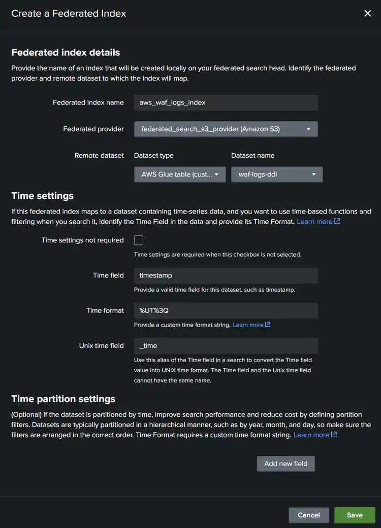

  3. Fill in the following fields to create an index:
    • Federated index name: eg aws_waf_logs_index
    • Select our new Federated Provider we created
    • Dataset type: Make sure (customer created) is selected
    • Dataset Name: Select our glue table name created earlier eg waf-logs-ddl
  4. Fill in the following fields to Time Settings:
    • Time settings not required: Leave unticked
    • Time field: timestamp (this is the timestamp field from AWS WAF logs)
    • Time format: %UT%3Q (this is UNIX time with millisecond format)
Sample screen shot with fields filled in:
Click Save when happy.

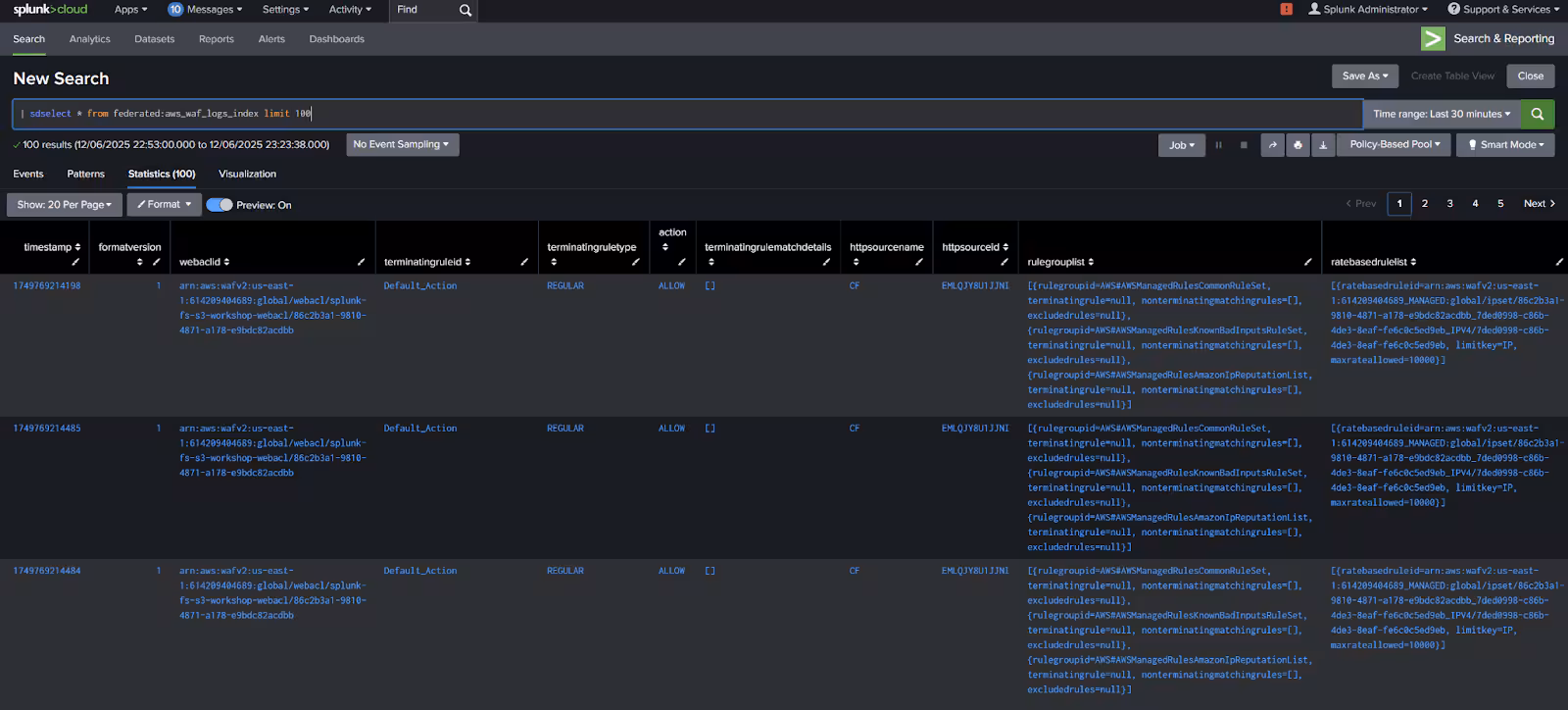

  2. From your search bar, let’s try a simple search. Copy and paste the below SPL into the search bar and click search:
| sdselect * from federated:aws_waf_logs_index limit 100
Note: it may take a minute or two for the permissions to propagate properly. But after a minute or two you should hopefully see the following result as an example:
That’s it! You have now configured a connection between Splunk and AWS to search in place your AWS WAF Logs.
