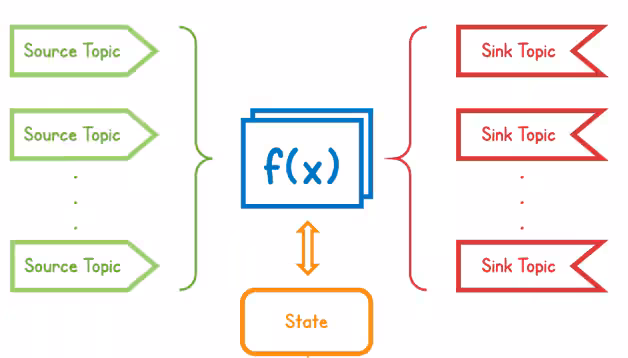

Event-Based Programming with Apache Pulsar Functions
Apache Pulsar Functions provides an easy-to-use framework that developers can use to create and deploy processing logic that is executed by the Apache Pulsar messaging system. With Pulsar Functions, you can write functions of any level of complexity in Java or Python and deploy them to a Pulsar cluster without needing to run a separate stream processing engine. Pulsar Functions are lightweight compute processes that:
Figure 4: The Pulsar Functions Programming Model
