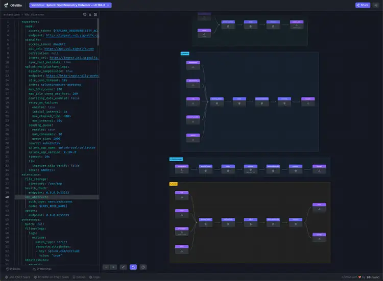

To help with these issues, the OpenTelemetry community has come to action with a great tool called OTelBin. With this (free and open-source) tool, you can not only visualize what your pipelines look like and see how each of the main signals flows through the collector, you can also get a syntax-highlighted, validated, YAML-linted version of the configuration in the same place. You can even validate your configuration against what components and config options are supported by several of the leading observability vendors, including against Splunk’s distribution of the OpenTelemetry collector (thanks to Splunker Robert Castley for submitting the PR needed to get this support added!)
Here’s a screenshot of what OTelBin can do. Notice that the config file is shown on the left and the resulting pipelines are visually represented on the right.
You’ll also notice the dropdown at the top of the screen letting you pick what distribution you’re using, letting you validate that all the components in your pipeline are supported by that distribution, and even detecting some common errors. For example, one common error is forgetting to supply an access token when setting up an exporter. OTelBin lets you see that easily:
Finally, let’s take a look at the closeup of a pipeline visualization:
In this example, you can see at a glance that for traces there are 4 receivers, 5 processors, and 2 exporters. Even though the config used to generate all the pipelines in this example is 482 lines long, you can easily determine where data is coming from, how it’s being processed, and where it’s going.
