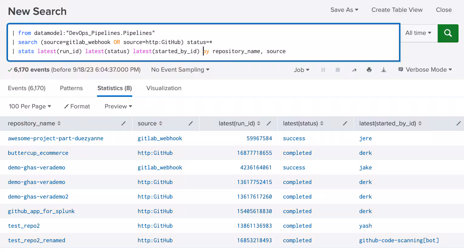

These commonalities are true of GitHub, GitLab, Jenkins, or really any software development related pipeline tool. By using these common linkages across pipeline data we can start unifying pipeline execution data like `run_number` (GitHub) or `job_id` (GitLab) into a single field like `run_id` for querying data from various pipeline tools. Similarly, regardless of how a given tool tracks the specific commit of code it is executing (or executing against), that commit hash can be aligned to `latest_commit_hash` and used as a linking field between other elements of the SDLC. With these two bits of information we can now see which `run_id` is related to an issue/ticket and associated code for a given `latest_commit_hash` by matching to the hashes associated with those issue and code objects (as described in Part 1 and Part 2 of this series, respectively).

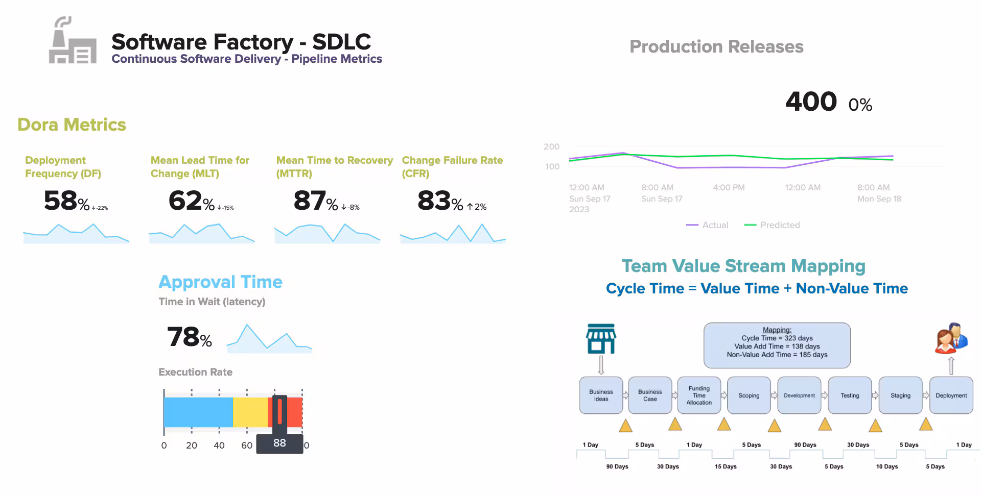

Obviously this helps paint a picture of a unit of work from conception and ticket creation, through code commit/push/PR, and now build/test/release/deployment via pipeline. From the software developer and PM perspective this incredible data for demonstrating and measuring productivity. Additionally, this data enables organizations to start tracking the now popular DORA metrics of Deployment Frequency, Lead Time for Changes, Change Failure Rate, and Time to Restore Service!
Using software pipeline data we can start to see “where the rubber meets the road” in terms of development efforts towards new features, added resiliency efforts, and other point in time changes to the greater software ecosystem of a given organization. Detailed and unified pipeline data is also invaluable during and after an incident as it helps to add context to the who, what, when, where, and why of what may have changed. Incident resolution also becomes much easier to track as pipeline data associated with code changes and rollbacks can be easily tracked from end to end. Even more impressively, by adding an attribute to monitoring metrics denoting the current running latest commit, the observability of a given code change can be tracked all the way into production. With that sort of data it becomes much easier to answer questions like “are we running any old instances that weren’t caught in the latest rollback or regression fix?” But we’ll get deeper into monitoring as this series of blog posts progresses!

- “What is the status of each of our pipelines and who started each of those runs?
