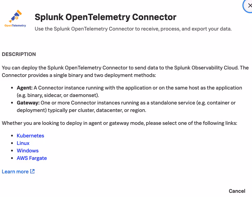

In the Connect Your Data window, select Splunk OpenTelemetry Collector, click the operating system version you would like to install the collector on and click Add Connection. For this example, we will use Linux. This will then present the data setup wizard, which walks you through the various installation requirements.

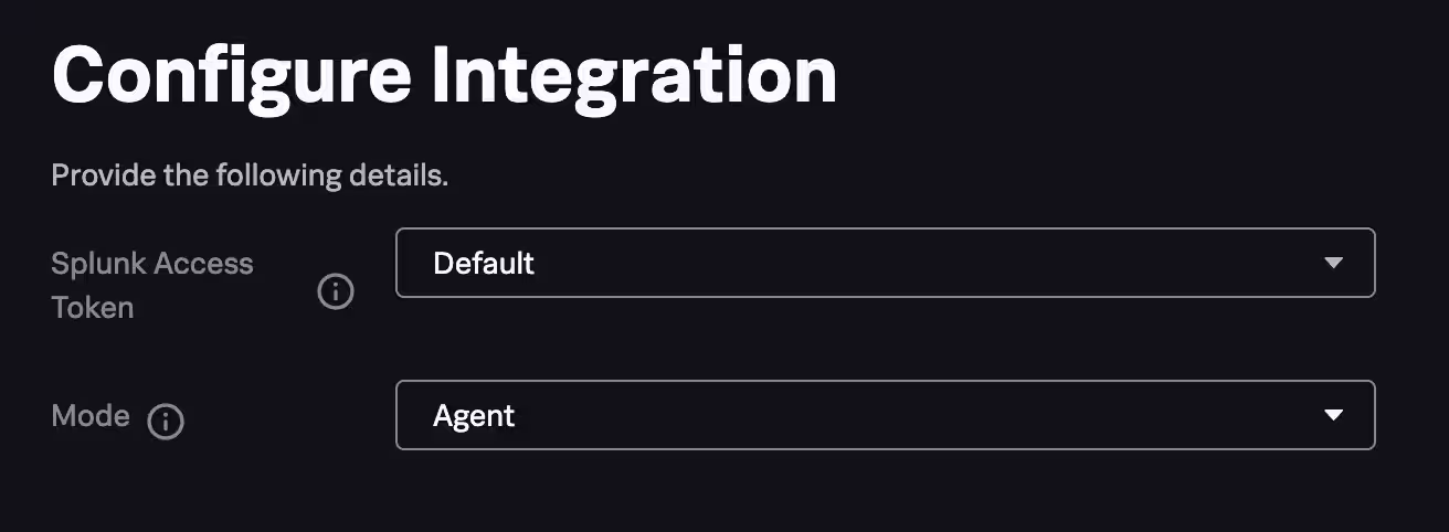

Next, we must choose which access token and deployment mode we would like to use for this deployment.
By default, one access token is created when you sign up for Splunk Observability Cloud. You can, however, create multiple access tokens. Access tokens are used to authenticate the integration with Splunk Observability Cloud and can be helpful when tracking usage for different groups of users. By default, these tokens can persist for five years and be used for API calls that continually send data points to Infrastructure Monitoring—more on managing access tokens here.
Deployment mode: allows you to select the type of deployment for your collector.
Agent: Will deploy the Splunk OpenTelemetry Collector instance running with the application or on the same host as the application. The diagram below shows a sample architecture of a standalone deployment.
Gateway (Advanced): Deploys one or more Splunk OpenTelemetry Collector instances running as a standalone service, typically per cluster, datacenter, or region. One common reason for deploying gateways is when hosts running the Splunk OpenTelemetry Collector cannot reach Splunk Observability Cloud. Standalone agents are then configured to send gathered telemetry directly to the gateway to be exported to Splunk Observability Cloud. The diagram below shows a sample architecture of a gateway deployment.

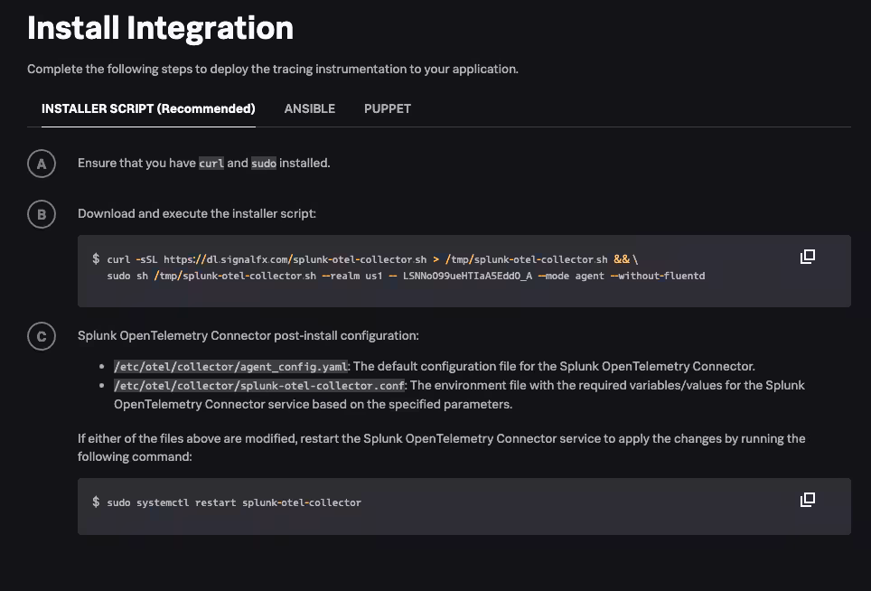

After selecting your access token and deployment type, you are prompted with an installation script specific to the operating system you have chosen for deployment. Since our example uses Linux, you can see the commands needed to complete the installation from the example below. Copy and paste the code shown in the Install Integration wizard to complete the installation.
Using sudo systemctl status splunk-otel-collector, we can confirm the installation of the Splunk OpenTelemetry Collector has been successfully deployed.

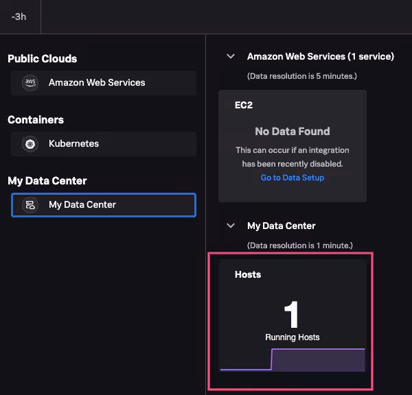

After about 90 seconds, data begins to populate metrics from your host on to Splunk Observability Cloud. To verify, let’s navigate to the infrastructure dashboard by clicking the hamburger menu and selecting Infrastructure.
Click on My Data Center to confirm your host is successfully sending metrics correctly.

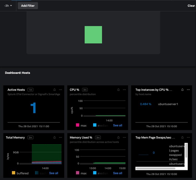

The dashboard now shows your host metrics, providing you with easy to understand charts and filter options for easy customization.
Now that the Splunk OpenTelemetry Collector is successfully exporting metrics from your host to Splunk Observability Cloud, you can easily use the various metrics collected to identify any potential infrastructure issues affecting your application workloads.
