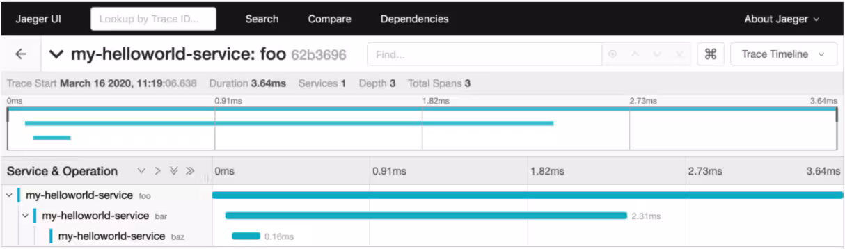

Run the following command to start Jaeger:
docker run -p 16686:16686 -p 6831:6831/udp jaegertracing/all-in-one
This command starts Jaeger locally on port 16686 and exposes the Jaeger thrift agent on port 6831. You can visit Jaeger here.

Finally, run the Python script:
python jaeger_example.py
