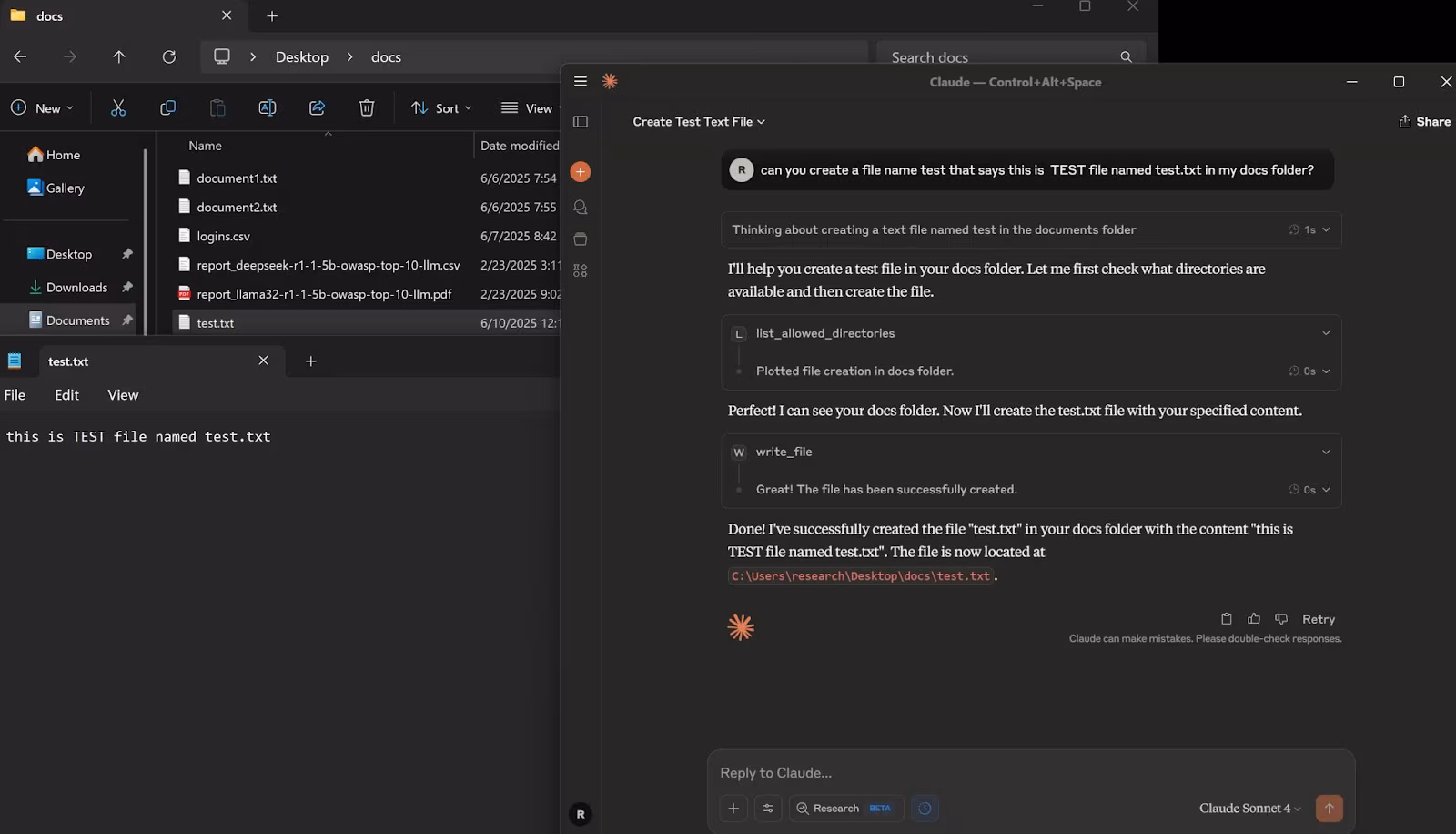

For this research two MCP Servers were created. A MCP file server (interacts with specified folders, can list, read and write files). A Splunk MCP server (interacts with the Splunk instance, including performing SPL queries, reading indexes and even performing application related queries). It is important to note that above actions can be limited by permissions and user’s rights. For example when using MCP file server, Caude desktop will ask you if you allow the action requested at your local system. With Splunk this can be addressed via Splunk accounts and roles permissions. Both of these MCP Servers were installed on a Windows 11 with NVIDIA 4070 GPU and 32 GB of RAM.
We are going to take a look at the log files created during the use of these MCP Servers. We will be focusing on the client (Computer running Claude Desktop). These logs are located in our setup at “C:\Users\--user–\AppData\Roaming\Claude\logs\”.

MCP Server Logs
mcp-server-filesystem.log
- File system MCP server communication
- JSON-RPC messages between client and server
- File operations (get_file_info, read_file, write_file)
- Real-time logging of all filesystem tool calls

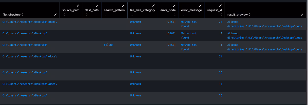

Spl Code - File Operations
index=* (sourcetype=*mcp* OR source=*mcp* OR source=*filesystem*)
("tools/call" OR "read_file" OR "write_file" OR "list_directory" OR "get_file_info" OR "create_directory" OR "move_file" OR "search_files" OR "directory_tree" OR "edit_file")
| rex field=_raw "\"method\":\"tools/call\",\"params\":{\"name\":\"(?P<file_operation>[^\"]+)\",\"arguments\":{(?P<full_arguments>[^}]+)}"
| rex field=full_arguments "\"path\":\"(?P<file_path>[^\"]+)\""
| rex field=full_arguments "\"content\":\"(?P<file_content>[^\"]{0,100})"
| rex field=full_arguments "\"source\":\"(?P<source_path>[^\"]+)\""
| rex field=full_arguments "\"destination\":\"(?P<dest_path>[^\"]+)\""
| rex field=full_arguments "\"pattern\":\"(?P<search_pattern>[^\"]+)\""
| rex field=full_arguments "\"paths\":\[(?P<multiple_paths>[^\]]+)\]"
| rex field=_raw "\"id\":(?P<request_id>[^,}]+)"
| rex field=_raw "\[(?P<component>\w+)\]\s+\[(?P<log_level>\w+)\]"
| rex field=_raw "Message from (?P<message_direction>client|server)"
| rex field=_raw "\"result\":{\"content\":\[{\"type\":\"text\",\"text\":\"(?P<result_preview>[^\"]{0,200})"
| rex field=_raw "\"error\":{\"code\":(?P<error_code>[^,]+),\"message\":\"(?P<error_message>[^\"]+)\""
| where isnotnull(file_operation) AND match(file_operation, "read_file|write_file|list_directory|get_file_info|create_directory|move_file|search_files|directory_tree|edit_file|read_multiple_files")
| eval operation_category=case(
match(file_operation, "read_file|read_multiple_files"), "Read Operations",
match(file_operation, "write_file|edit_file"), "Write Operations",
match(file_operation, "list_directory|directory_tree"), "Directory Browsing",
match(file_operation, "search_files"), "File Search",
match(file_operation, "get_file_info"), "File Information",
match(file_operation, "create_directory"), "Directory Management",
match(file_operation, "move_file"), "File Movement",
true(), "Other Operations"
| eval file_extension=if(isnotnull(file_path) AND match(file_path, "\."),
replace(file_path, ".*\.([^\.\\\\]+)$", "\1"),
if(isnotnull(file_path), "no_extension", "N/A"))
| eval file_directory=if(isnotnull(file_path),
replace(file_path, "^(.*)[\\\\/][^\\\\/]+$", "\1"),
"N/A")
| eval file_name=if(isnotnull(file_path),
replace(file_path, "^.*[\\\\/]([^\\\\/]+)$", "\1"),
"N/A")
| eval operation_status=case(
isnotnull(error_code), "Failed",
isnotnull(result_preview), "Success",
message_direction="server", "Response",
true(), "Request"
| eval file_size_category=case(
match(result_preview, "size:\s*(\d+)") AND tonumber(replace(result_preview, ".*size:\s*(\d+).*", "\1")) > 1000000, "Large (>1MB)",
match(result_preview, "size:\s*(\d+)") AND tonumber(replace(result_preview, ".*size:\s*(\d+).*", "\1")) > 100000, "Medium (100KB-1MB)",
match(result_preview, "size:\s*(\d+)"), "Small (<100KB)",
true(), "Unknown"
| eval timestamp_formatted=strftime(_time, "%Y-%m-%d %H:%M:%S.%3N")
| eval hour_of_day=strftime(_time, "%H")
| eval day_of_week=strftime(_time, "%A")
| sort -_time
| table timestamp_formatted, component, message_direction, operation_category, file_operation, operation_status, file_path, file_name, file_extension, file_directory, source_path, dest_path, search_pattern, file_size_category, error_code, error_message, request_id, result_preview

- Input validation: Monitor malicious payloads in tool parameters, prompt injection attempts and command injection patterns.
- Configuration Changes: Security patches and dependencies update.
- Sandboxing: Session isolation, database proxy, process level isolation, permission based tool access.
As we have seen in this blog we can certainly monitor the data produced from MCP Servers at the client level. With this information plus backend logs as the ones explored in the previous blog. We can comprehensively address the use at client and server side of LLM models not only from the direct usage (what was prompted or imputed) but also from the platforms running clients and server backend.
